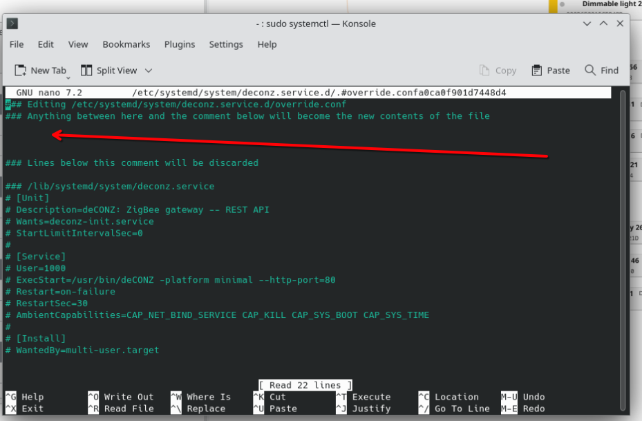

I’m not able to add to the issue directly, but please use:
sudo systemctl edit deconz
instead of:
sudo nano /lib/systemd/system/deconz.service
This way, your changes won’t be overwritten by apt upgrade.
@Haerteleric
Maybe you should specify this a bit more. With your suggestion it is not possible to save a changed configuration.
ExecStart=
ExecStart=/usr/bin/deCONZ -platform minimal --http-port=80 --ws-port=8443
add this to where there arrow points:
