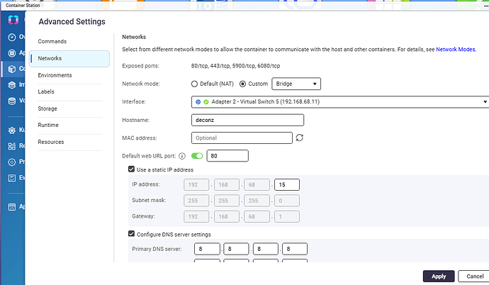

Can please someone explain what to do that alexa is working normaly with the deconz container.
Hello. I am running deconz in a docker container and I am struggling with what environment variables I have to change to make deconz work with alexa again. Could someone explain please?

Thank you for your help! If I don’t get this wrong this is the config for the solution with a nginx reverse proxy.
The developers implemented a fix for this problem in version 2.32.0. I am struggling to get it to work, because I don’t know how to configure it. I would be grateful if someone could help me out.
The initial HTTPS support in the last version unfortunately had some issues getting it work in some setups. This is fixed in the upcoming version. I can’t test the Alexa connection since my Echo refuses to finish setup to my WiFi.
From a container perspective the internal HTTPS port 443 needs to be exposed to the outside.
Hi manup, can you please explain more in detail? I am using deconz now for more than 4 years and everthing was fine. Now since August it is not working as expected and now I read you answer. Which upcoming version are you talking about? Firmware? Docker? and how do I have to expose the HTTPS port 443?

I am using deCONZ on my Qnap Discstation TS-253D with Container Station.
I’m afraid I can’t help much since I have no experience with how it works with Qnap.
Might be worth to check if the 443 port is already reachable from outside of the container:
curl -k -vv https://192.168.68.19/api
