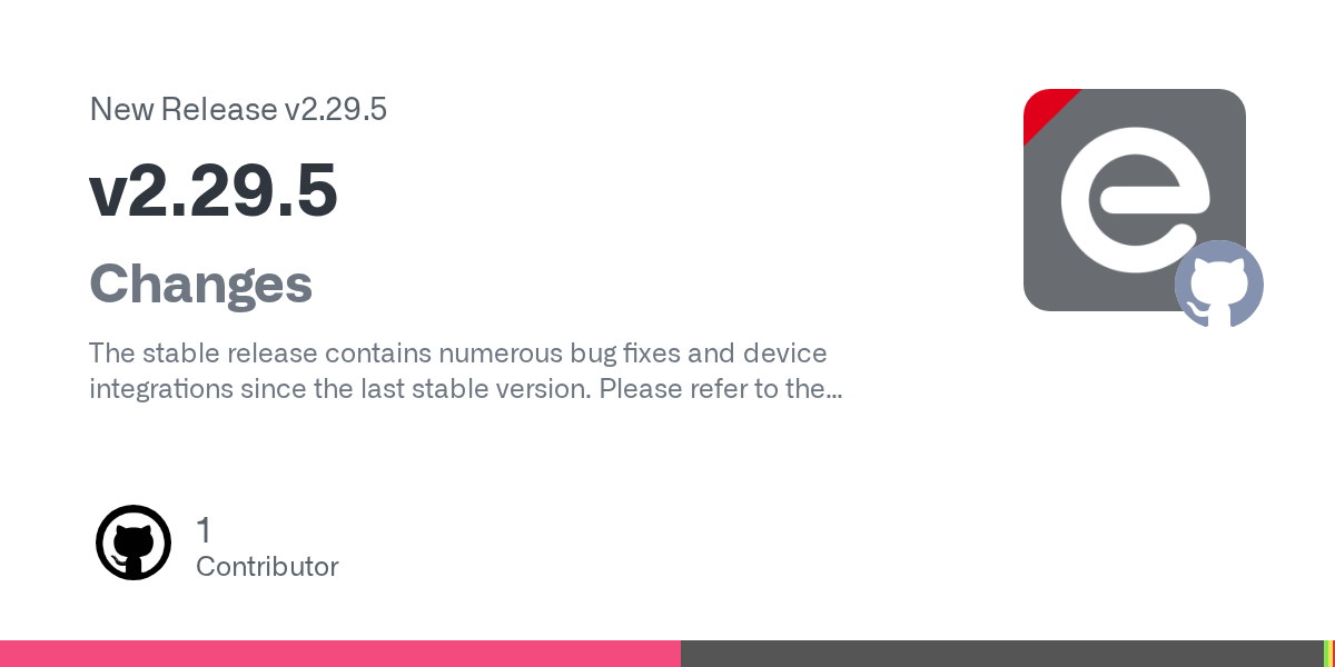

Could anybody please check if the problem also occurs with older deCONZ versions, e.g. stable version v2.29.5?
Hi @manup
I would like to but that version since not available anymore with apt. How can I get it?
Here is the Link:
I just tested it. Unfortunately, it doesn’t work for me.
2.28.1 and 2.29.5 for me, doesnt change anything.
