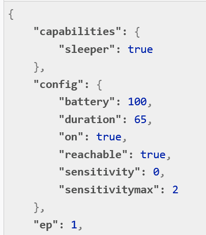

Sensitivity reported as 0 in Phoscon API. Can I trust that value? Another theory is the sensitivity is way too sensitive and actually higher than shown. Just a random guess, based on the sensitivity trouble from Aqara vibration sensor resets sensitivity.
The values currently used when configuring the sensitivity are the same the official Aqara hub is using. These where obtained by sniffing the traffic of the hub and sensor https://github.com/dresden-elektronik/deconz-rest-plugin/pull/7208

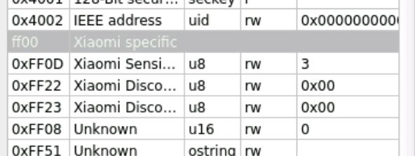

See Discord, upon sniffing the Aqara app / Hub M2, it appears that the Xiaomi vibration sensor uses Zigbee values 1: High, 2: Medium, 3: Low.
The device seems to accept and report back any value, even higher then 21. This was carried over from the C++ code when the sensor was supported initially, but, apparently, never verified.
Note they are inverted to what the deCONZ REST-API has as we map 0 = low, 1 = medium, 2 = high.

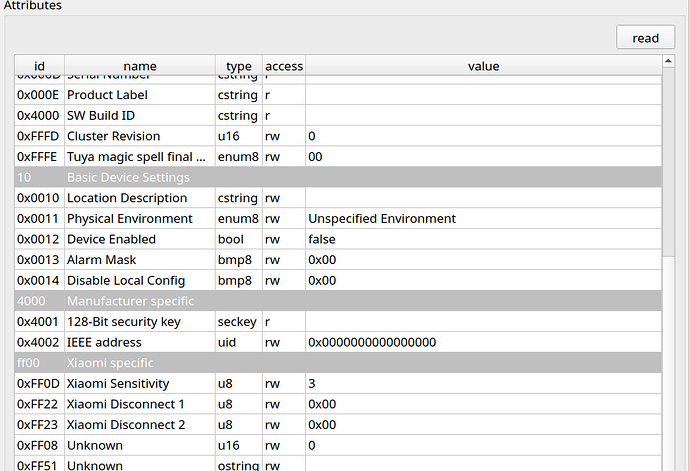

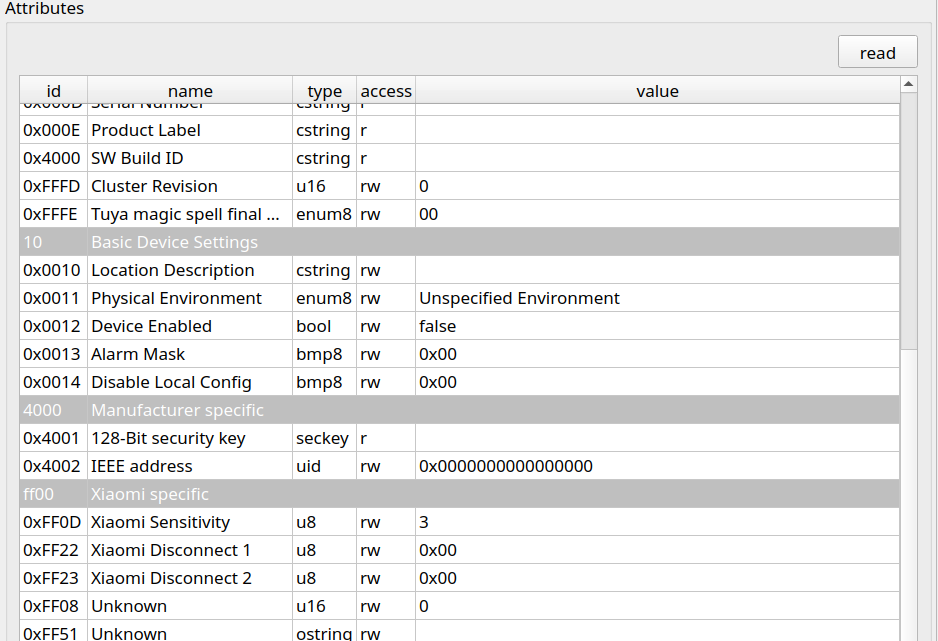

The actual currently on device value can also be seen in the deCONZ GUI Cluster Info Panel on the Basic Cluster, the attribute is 0xFF0D. The attribute is queried once per hour and updated if different to the API configuration.
Here in my case the API is configured as { sensitivity: 0 } hence the attribute is 3.

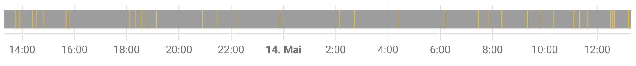

So how to proceed. 2 out of 3 sensors still with massive phantom trigger events since deCONZ 2.29.5. Running latest 2.30.2 and still nothing improved.

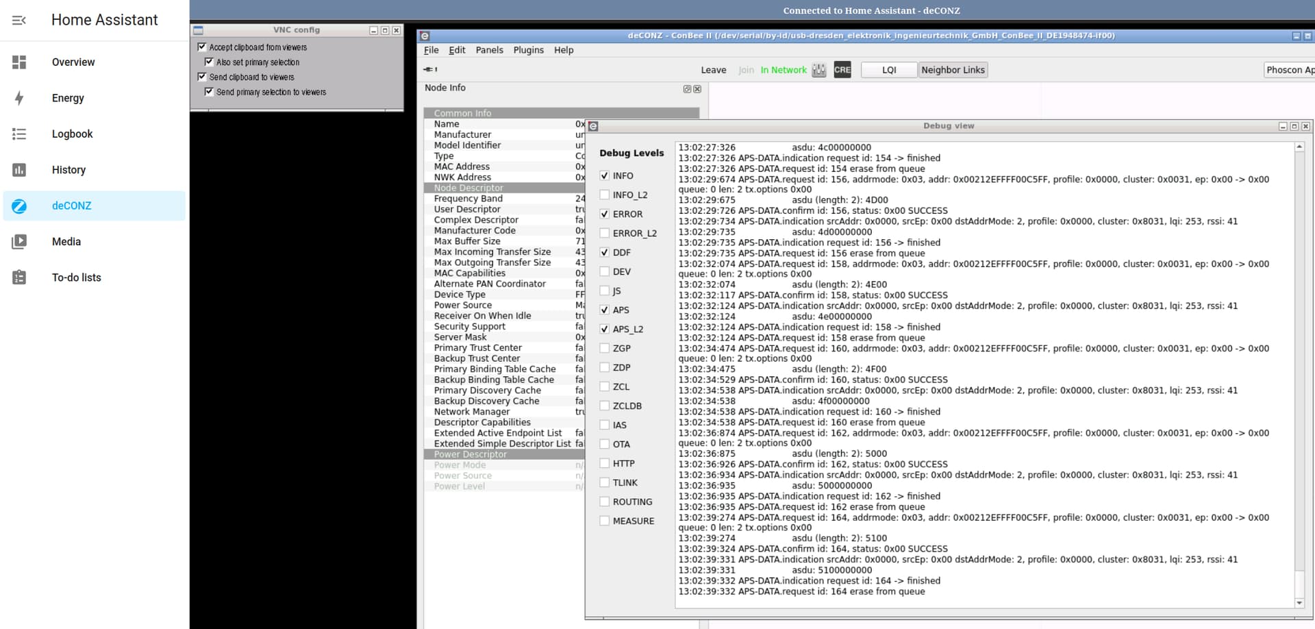

In the add-on configuration the logging can be enabled in the configuration.yaml
The add-on configuration.yml needs to enable logging for info and aps
device: >-
  /dev/serial/by-id/...<your-device>
dbg_info: 1
dbg_aps: 2
The add-on Logs tab should then show respective output.

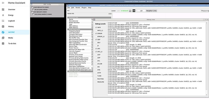

Or to only enable the logs for a session you can open the deCONZ GUI via VNC of add-on and enable them in:
Help → Debug view
These are also shown in the add-on Log tab and can be copied from there.

Following up on the log data gathering by manup @ https://forum.phoscon.de/t/lumi-vibration-aq1-sensor-with-phantom-triggers-since-deconz-2-29-5/6305/50:
I prefer the deCONZ GUI / VNC path. But: even the false triggers happen quite often, sometimes there’s nothing for a few hours. So I wonder what’s the best (or only?) strategy to efficiently collect logs:
  1. Enable debug logging
  2. Wait until a false trigger appears
  3. Ideally immediately head to the debug log, copy/save the logs and stop the debug logging
  4. Filter the log around the time the false trigger appeared and provide those logs here
Correct?
