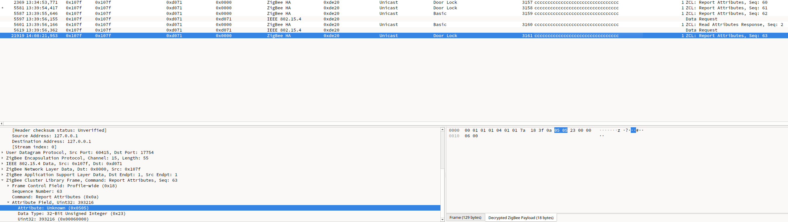

Lumi.vibration.aq1 sensor with phantom triggers since deCONZ 2.29.5
The state/vibration value is updated on Cluster 0x0101, attribute 0x0055.
05:10:11:722 ZCL attribute report 0x00158D00010FCC9D for cluster: 0x0101, ep: 0x01, frame control: 0x18, mfcode: 0x0000
So the device is realy sending a request. Unfortunately we haven’t the value, it’s possible to have it if you enable APS+APS_l2, we will have the “asdu”.
Edit:
After a check, this device send only request on vibration on attribute 0x0055, value is 0x0001,0x0002 or 0x0003, so it’s deconz that “reset the detection”.
But it mean your device have probably detected something.
From what I m reading the device never make norification if there is nothing.
Will be usefull the see the attribute in the report and the value.
And it’s a report, so it’s not deconz that is polling the device, it’s a “natural” notification.

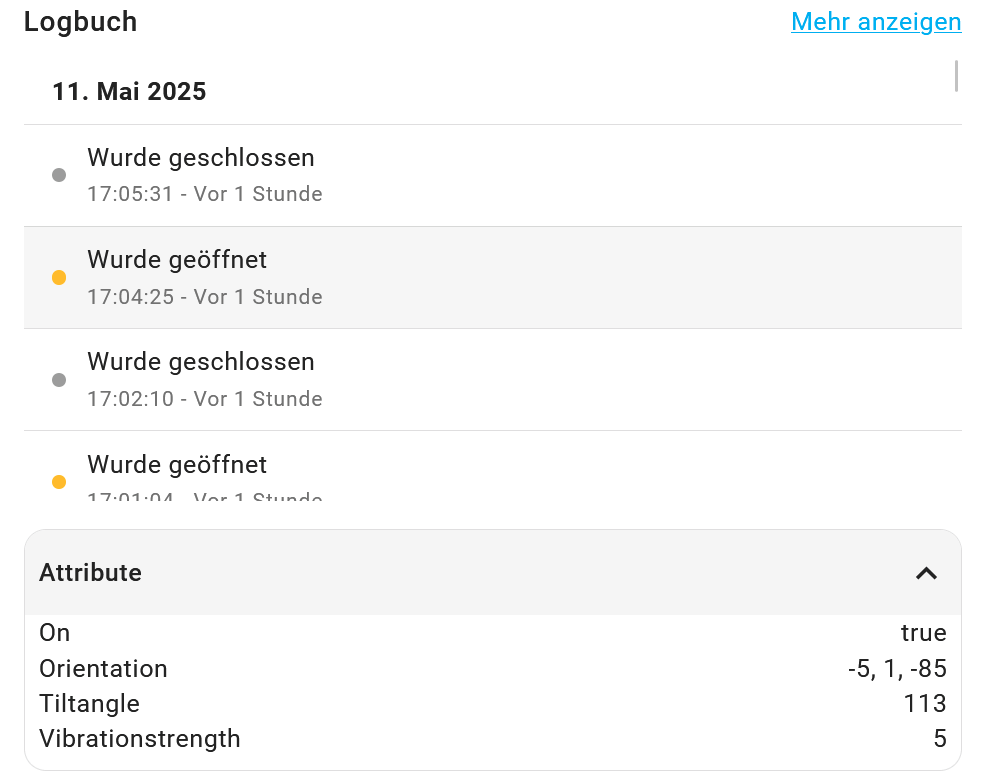

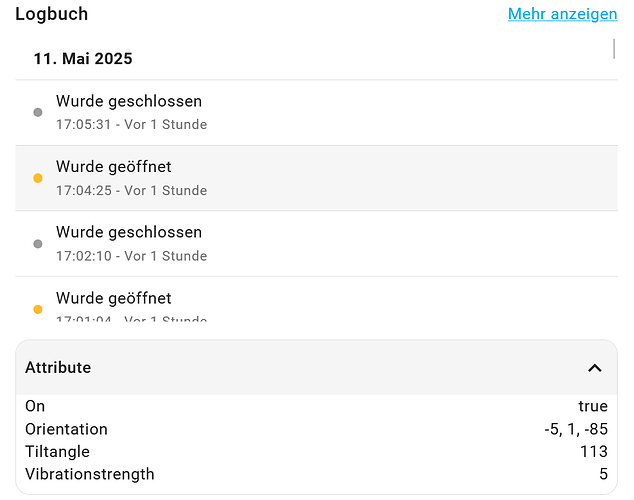

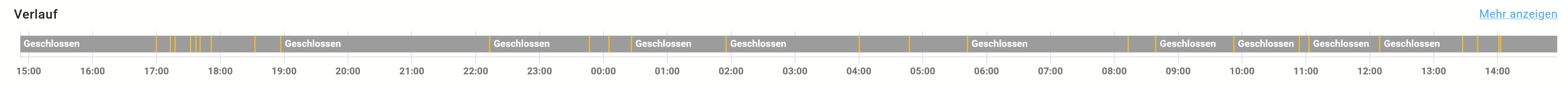

Hi @Smanar ,
Here is 2 logs of “phantom” events:
1/ Vibration detected at 14:09:08 and “disabled” at 14:10:13

Also for my most freaky vibration sensor, sensitivity is set to 0, as always:
    "capabilities": {
        "sleeper": true
        "battery": 98,
        "duration": 65,
        "reachable": true,
        "sensitivity": 0,
        "sensitivitymax": 2
And still all events in the last 24 hours (with deCONZ v2.30.2) are false positives, 100 % phantom/ghost trigger events - meaning: no physical movement of the sensor has happened.
@bcutter how/on what does your event in HA trigger? Does it look at the vibration equals true attribute or only that any state* event from the sensor is arrived or state.lastupdated is new?
I’m asking because while looking at my sensor that the state.lastupdated is refreshed at some “random” points in time and a state event is fired on Websocket containing all attributes, but with vibration = false, which is correct so far.
This happens since the sensor sometimes sends a attribute report for the vibration strength attribute 0x0505 which then causes the state.vibrationstrength and state.lastupdated to be refreshed.

In the sniffer it looks like this:
The state.vibration attribute in my case stays false all the time unless I shake the sensor.

For the plug, no idea ^^, and it’s not a zigbee setting like “state on power” as nothing is moving on the device.
About the sensor, just by curiosity, only on=true is moving ? I mean Tiltangle, orientation and VibrationStrenght not changing ?
They are not visibles on logs, not the same attribute, but it’s just to be sure.
Did you check and double-check the battery? Aqara sensors tend to issue ghost events when the battery is low. Don’t rely on the value reported by deCONZ - this is extrapolated from the battery voltage reported by the sensor. Any value other than 100% is suspicious.
I certainly could check the batteries. But why should two vibration sensors start with ghost trigger events right after updating deCONZ. Software updates don‘t wear out sensor batteries, right.
Curious to see how things work once hiteule downgraded deCONZ.
Set the sensivity to 0 (low) via the rest api does not help.

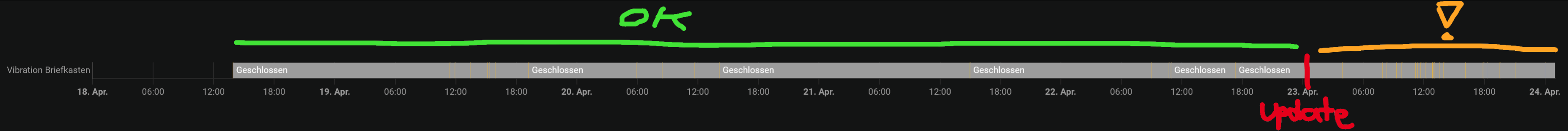

Well, since the replacement of the CR2032 battery yesterday morning… there is no more “ghost event” in the last 24h on my side.
I don’t know if it’s the fact that I “rebooted” the sensor (by changing the battery) or if the battery was “dead”.
I can’t understand why this problem appeared at the same time as the upgrade, it must be a simple coincidence.
I’m sorry to have bothered you, but I never imagined that the sensor could go “crazy”.

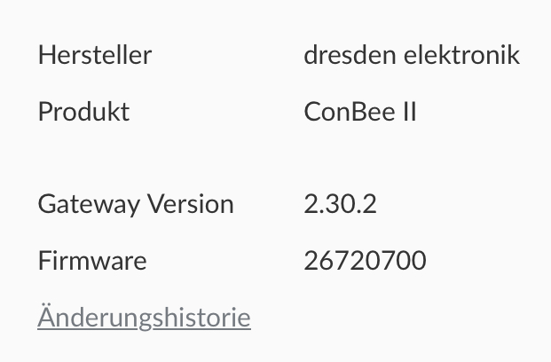

For the record, here is my setup:
  • Conbee 2
  • Firmware 26720700
  • Rest-plugin 2.30.2

Still strange: same devices for several users went crazy right after a deCONZ update where the sensor‘s firmware, sensor‘s battery etc. does not change - only the connection is disconnected shortly and handled by a new deCONZ version.
