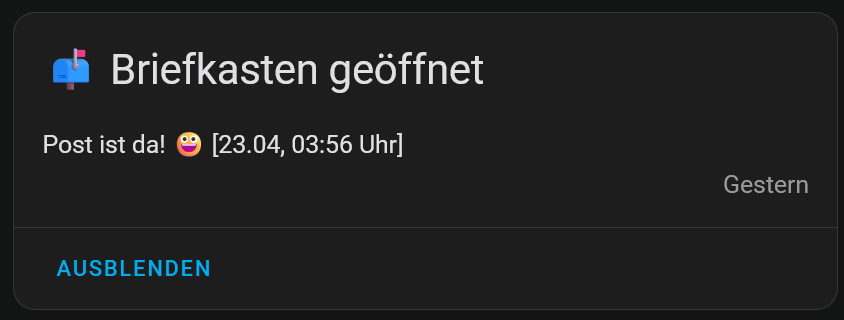

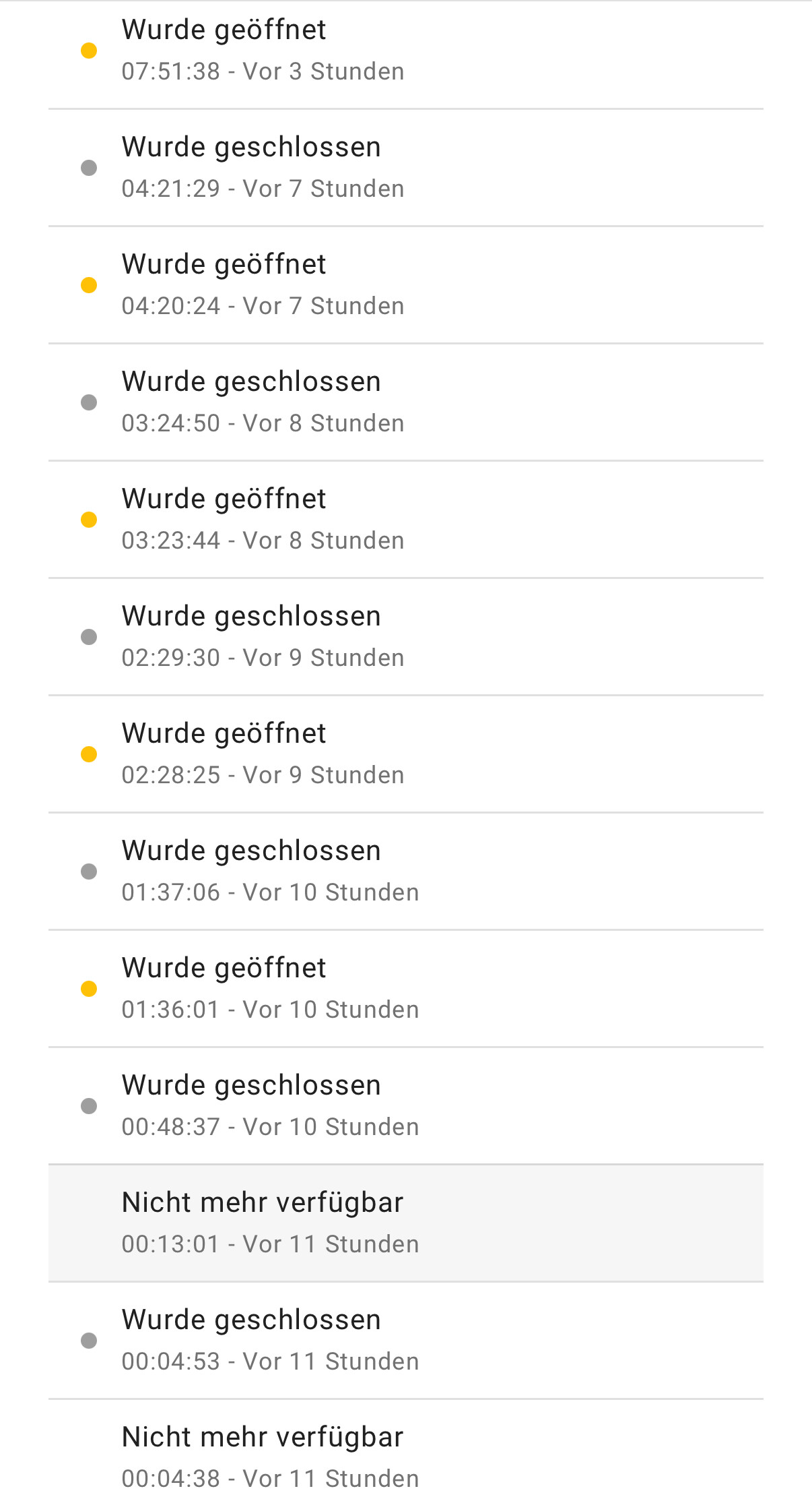

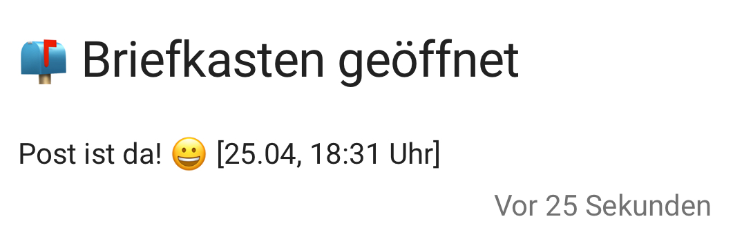

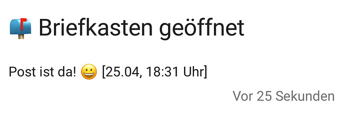

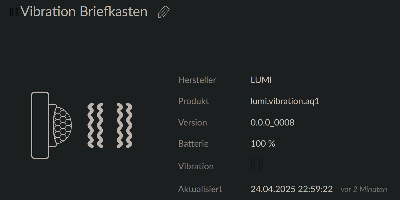

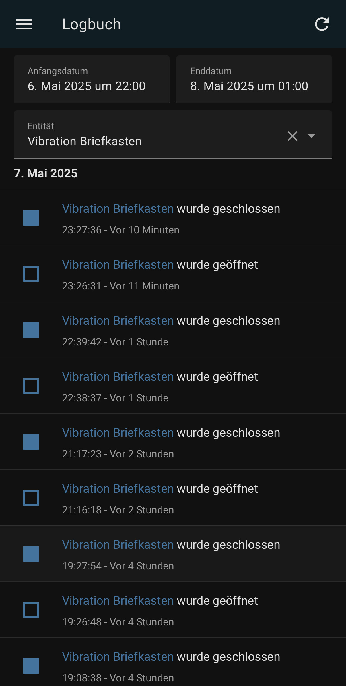

Since updating deCONZ to latest v2.29.5 yesterday, another vibration sensor, working completely fine so far, now wents nuts, meaning: it is triggered very often for no obvious reason (no actual vibration!). 19 triggers in last 40 hours, where 16 to 17 were false alarms (phantom/ghost triggers) and few right in the middle of the night…
First one shortly after updating deCONZ:

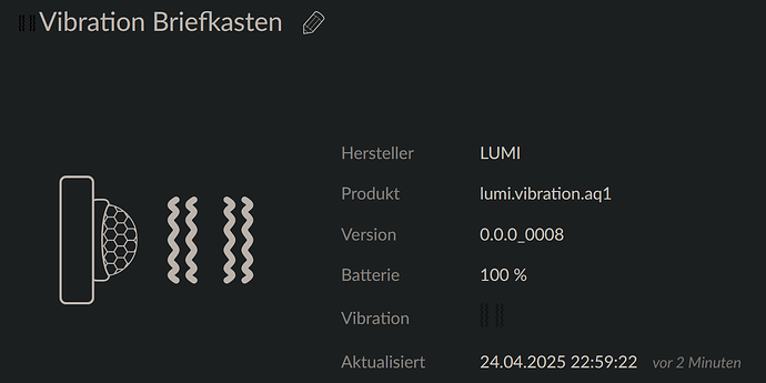

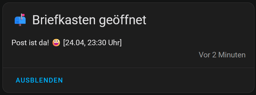

Last one of those 19 (up to now):
Before/after comparison:
API excerpt for that sensor
catched right now during last phantom trigger:

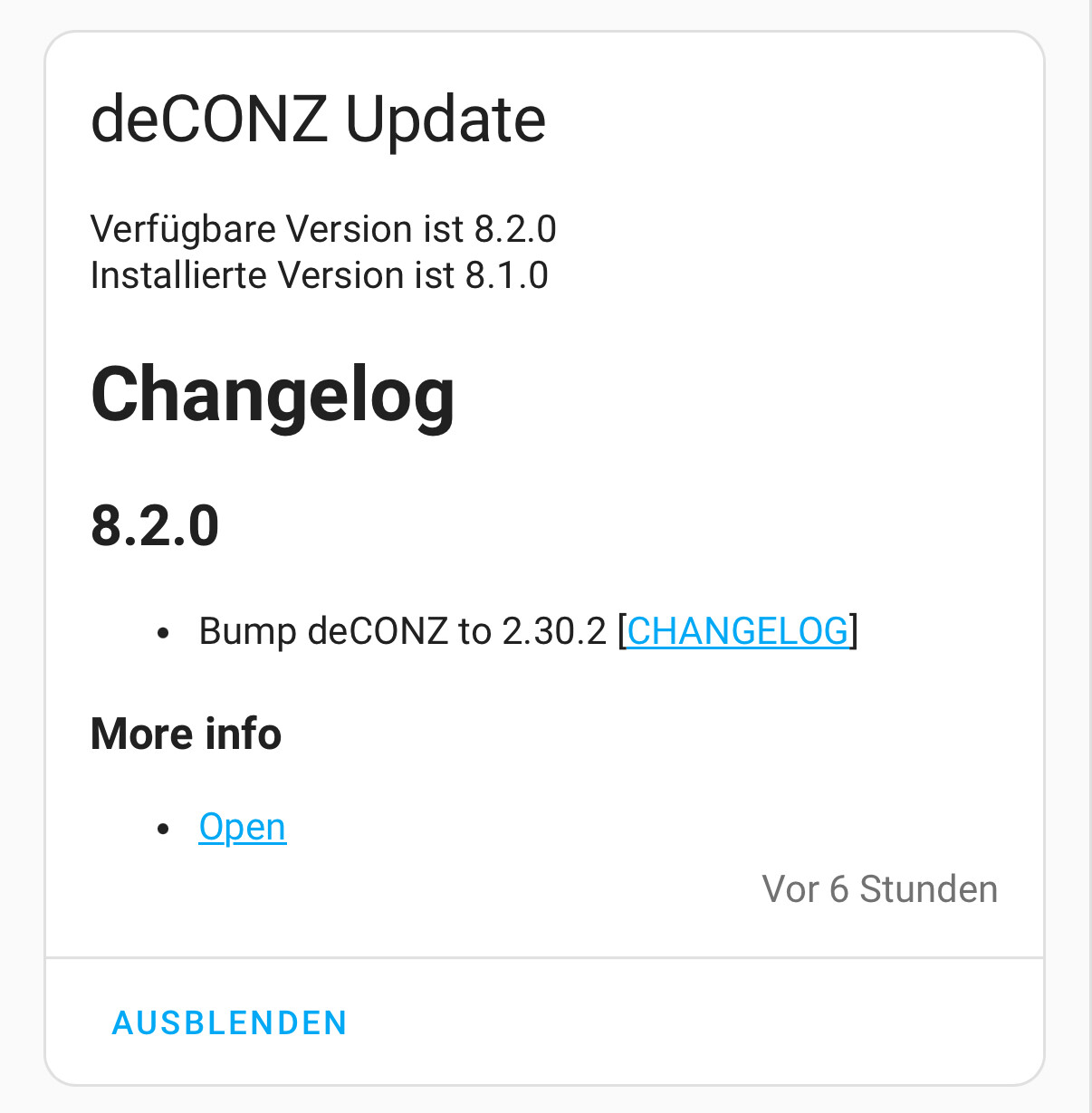

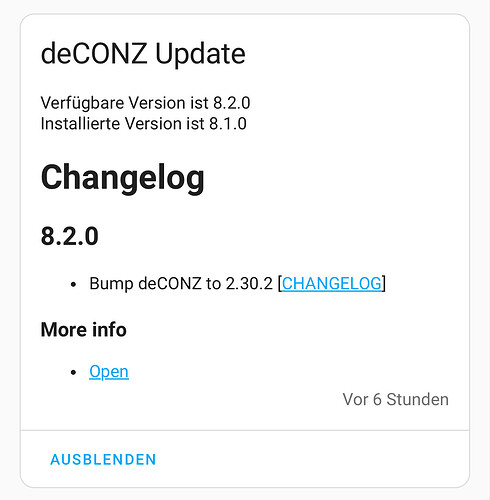

:arrow_right: How to bring the new v2.30.2 stable release to the HA deCONZ addon?
The last troubleful updates where it in some cases took months for the update to arrive was e.g.
EDIT: ah here‘s the PR. Grabbed my popcorn and stop watch, finger‘s crossed :crossed_fingers:t3:

And here it is, only 1 day later arrived for HA addon users:
Phenomenal :tada::+1:
Going to update and test vibration sensor behavior soon.

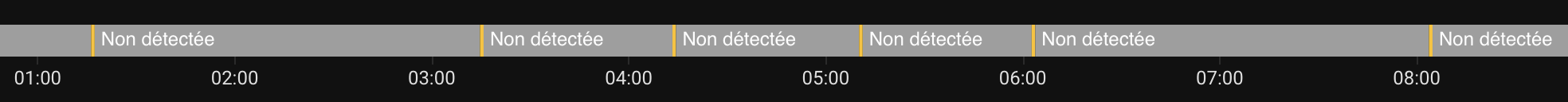

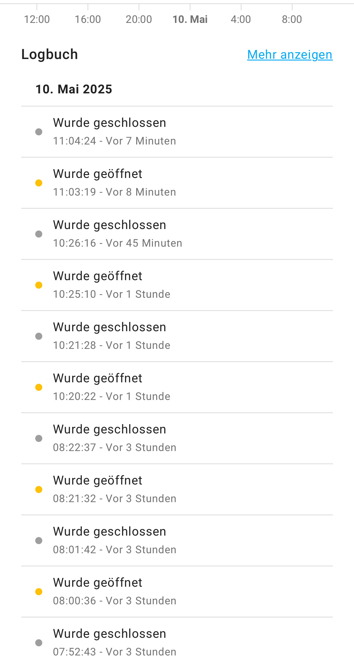

I have updated on 2.30.2 (via the 8.2.0 HA addon) yesterday and the problem is still there on my side.
Example of this night, there is phantom event every 1 or 2h (around):
Here is some example of the associated logs I can see on the deconz addon logs:
1/ Vibration detected at 05:10:11 and “disabled” at 05:11:16

2/ Vibration detected at 05:02:44 and “disabled” at 06:03:49
