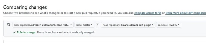

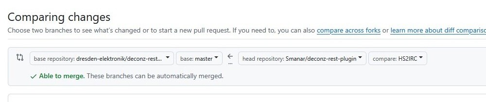

Then you can do the PR procedure, Pull Request/New pull request up to have something like That
Here the branch is called HS2IRC
And after it’s always the green button.
