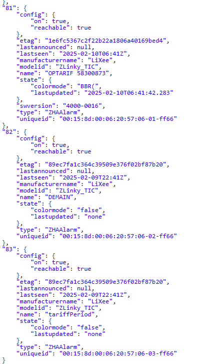

That poses a problem. Detection of the start of HC is done with ‘PTEC’. But if deconz doesn’t update the API exactly at HC (10 p.m.), nothing starts at 10 p.m., the water heater and my car charging. That’s a big problem. Same for HP (6h) if the day is red tempo, nothing stops immediately.
And ‘DEMAIN’ never shows with ZHAalarm state/colormode

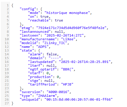

Still having ‘----’ ?

I modified my DDF by adding this cluster/attribute, it doesn’t work.
Checking, I have OPTARIF which seems not to work, corresponding lastseen is not updating.

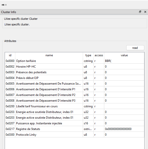

In the application I do not see the new attribute 0x10 in cluster 0xFF66
Can add the the file general.xml (the middle line)
        <attribute id="0x0000" type="cstring" name="Option tarifaire" access="r" required="m"/>
        <attribute id="0x0001" type="cstring" name="Couleur de demain" access="r" required="m"/>
        <attribute id="0x0002" type="u8" name="Horaire HP-HC" access="r" required="m" default="0x00"/>
And (the middle line too)
        <attribute id="0x0008" type="u16" name="Avertissement de Dépassement D'intensité P3" access="r" required="m" default="0x00"/>
        <attribute id="0x0010" type="u16" name="Tarif period" access="r" required="m" default="0x00"/>
        <attribute id="0x0200" type="cstring" name="Libellé tarif fournisseur en cours" access="r" required="m"/>
But we miss information about this attribute, what is the type ? I m using u16, but it’s random. If you try to read it with the GUI the type can be corrected.
I don’t see a line with the attribute 0x0010 on your last DDF ?
Yes I removed the json with 0x0010, it didn’t work.
And I don’t know where to find general.xml on docker synology.
If I do it on deconz windows it won’t change anything under docker? nothing to see I guess
the 0x0010 attribute is updated in ZLinky as soon as PTEC is modified. tariffPeriod goes up much faster than PTEC. like PTEC it is a 4 character text

is it the right file?
Ha yes, more complicated on docker.
Yes it’s the good file deconz-rest-plugin/general.xml at master · dresden-elektronik/deconz-rest-plugin · GitHub
But you can use a second xml to add feature to the original file, on deconz menu, edit > preferences > ZCLBD and you can add a file stored in a presistent folder on the docker.
I don’t found sample but the procedure is here https://www.dresden-elektronik.de/funk/software/deconz.html?file=files/dresden-elektronik/content/downloads/dokumente/funktechnik/deCONZ-BHB-en.pdf > “10. Extending the ZCLDB”

For me like you have done with the "state/colormode" need to work, even it’s an hacky way, but for test no problem.
You have only "false" as result ? what is the value in the GUI ?
I use two alarms in my ZLinky json. If I put a third one, it doesn’t work. Something goes wrong because it is never updated. I’ve been trying to find a solution for three days. I also have a light that appears when it doesn’t exist. Do you have a ZLinky module to test my complete json? FYI the tariffPeriod value comes back instantly. It corresponds to PTEC, current tariff period.

And here is the information that is returned, in addition to the 6 consumptions:
You find the Linky mode, and the titles corresponding to the historique mode and the standard mode, and the production which is the injection of solar panels into the network.
Of course, only the informations corresponding to the Linky mode are updated.
It works for all modes ? But for standard users, the index is 0x0000 and 0x0100/0x0102 for HP/HC.
But there is so usefull stuff, it’s a shame is so hard to include officialy new fields to use on DDF
I think x0100 is also the index for BASE.
in my opinion there is an error/oversight, but I cannot check because I am in tempo.

Ha, right, it’s possible, there is something strange, if you look the “synthese developpeur”
The attribute 0x0000 is no more used, its now 0x0100
Perfect. I didn’t understand why it wasn’t 0x100.
I assume that 0x0000 is used for the sum of all indexes, which corresponded to the Base index for the one that always stayed with a Base tariff. Otherwise following the change from 0x0000 to 0x0100, it would no longer have worked mysteriously for those who were in Base.

          "name": "attr/name",
            "fn": "none"
          "static": "index0"
Ha yes, it’s a a good idea to put the index name in the DDF, better than the native incremental one.
But if you use
"static": "index0"
This one is locked after nope ?
Perhaps better to use
"default": "index0"
I tested with "static": "index0" . It’s not blocked, I can change the device name.
Maybe it does the same thing because there is "fn": "none"
