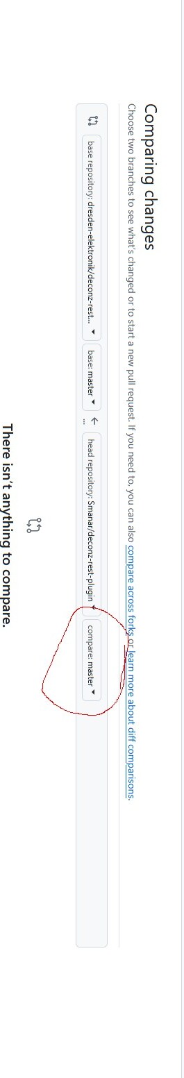

I’m doing it from my smartphone and I can’t find how to do it. I can’t find submit PR. I’m giving up.
Yes better on real PC, but you just need to edit the general.xml on your master branch, and the changes will be synchonised on your PR.

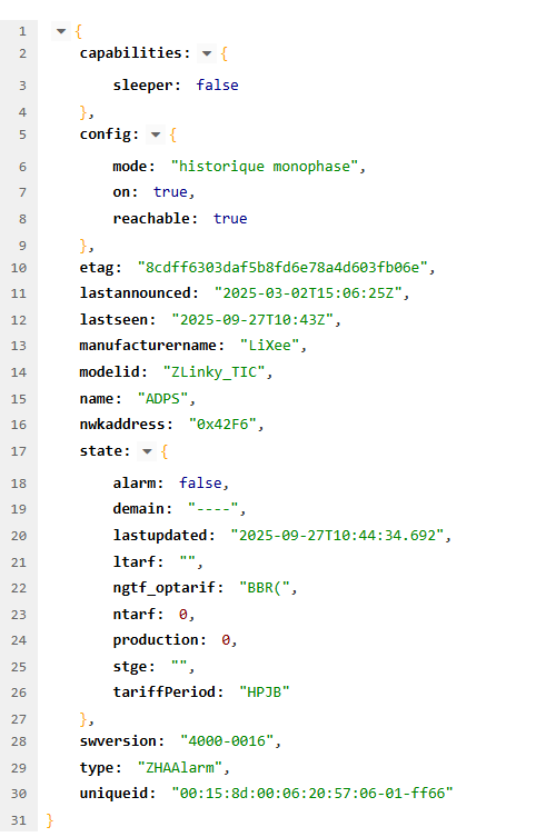

Here’s what my usage is like. I’m in history mode and Tempo, but it works in standard mode, of course and production.

You can see all the data uploaded by the Lixee in the screenshot above, some are uploaded in Historical mode, others in Standard mode. There are also the 6 consumption indexes that are uploaded depending on your tariff, only one in Base, 2 in Hphc and 6 in Tempo. If you want other information to be uploaded, I can see what I can do.
