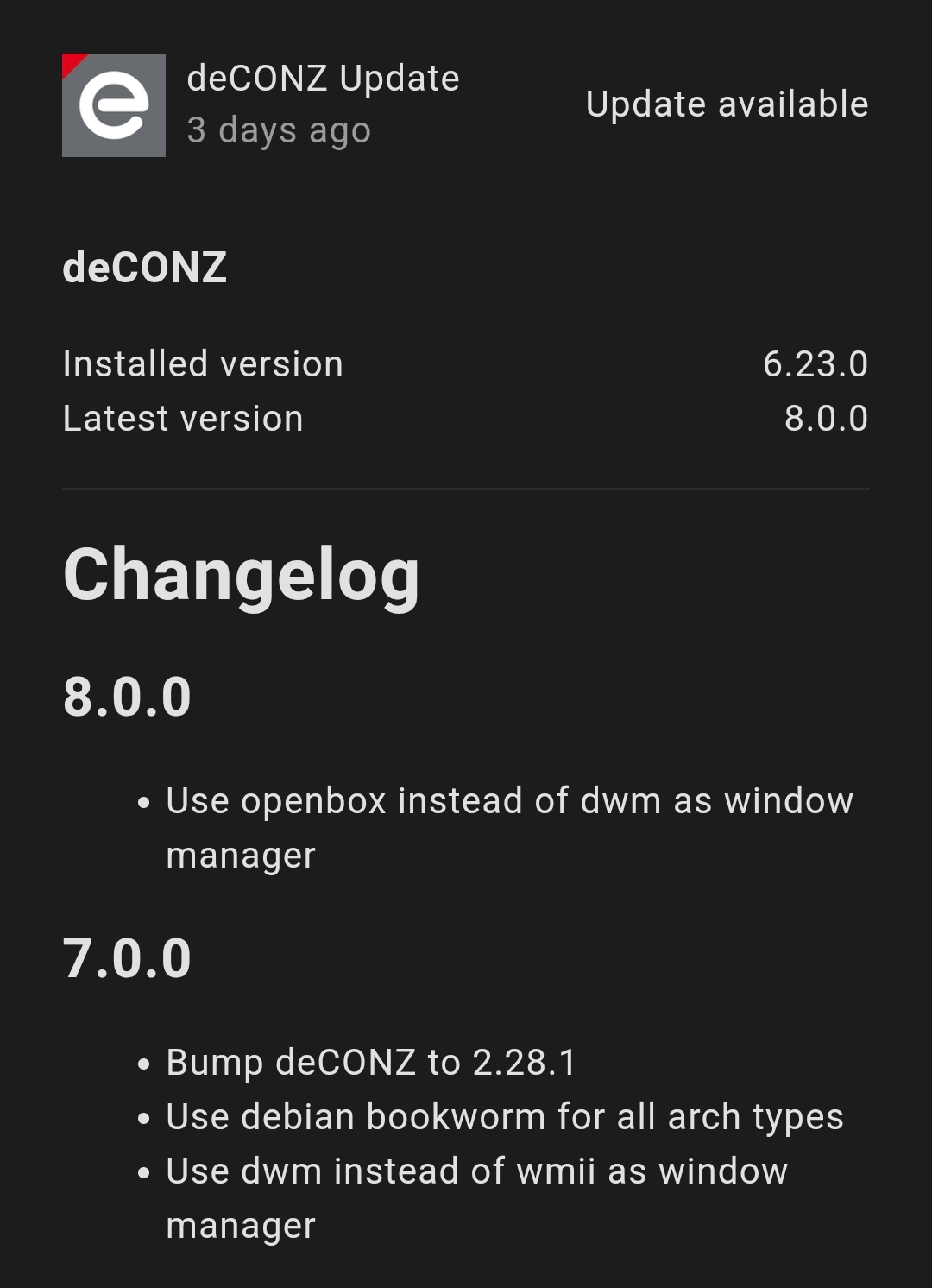

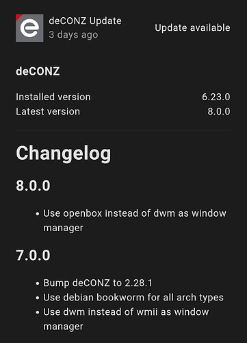

Thanks for that github link put reading from the last post backwards gave me the impression its not safe to update here?
