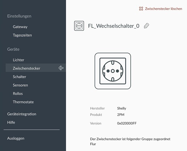

Shelly 2PM Gen4 no power data
i am using last stable Version 2.32.5.
There is no still no power data displayed for shelly 2PM Gen4
See https://github.com/dresden-elektronik/deconz-rest-plugin/issues/8316
Unfortunately, the two DDFs were not tested in the issue. Depending on how the Shelly is configured (switch or cover), deCONZ should select the correct DDF. Once the files are in the device folder, the device must be deleted and re-paired.
I think deconz select the wrong ddf.

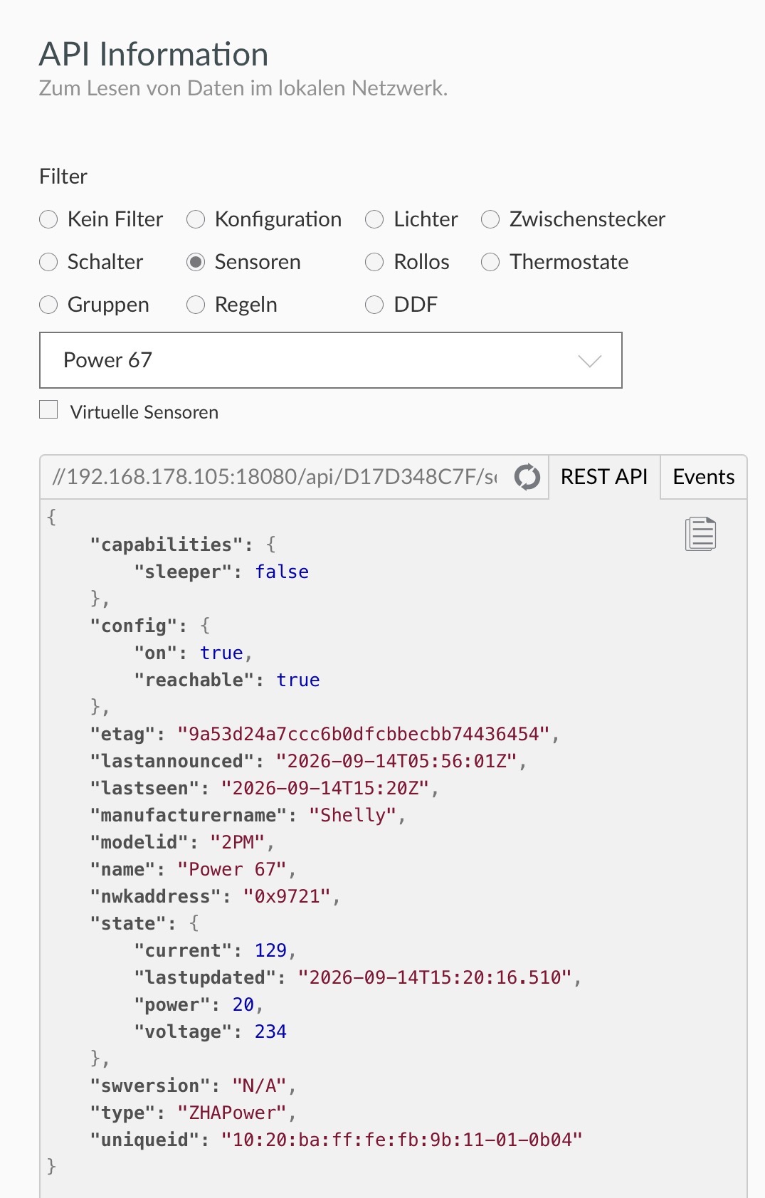

It works, could anyone please check in both files?

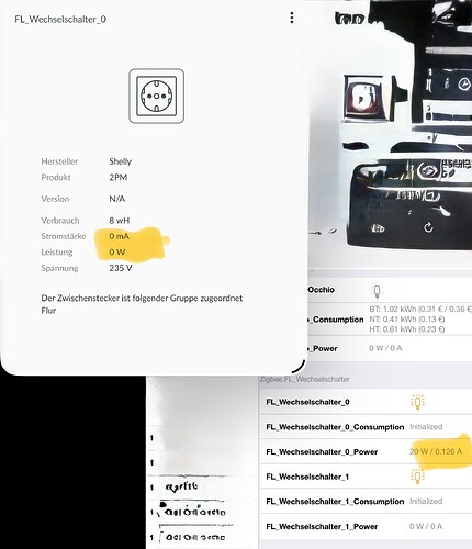

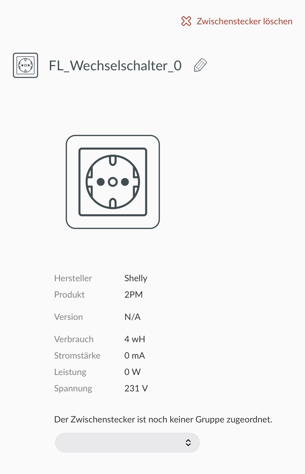

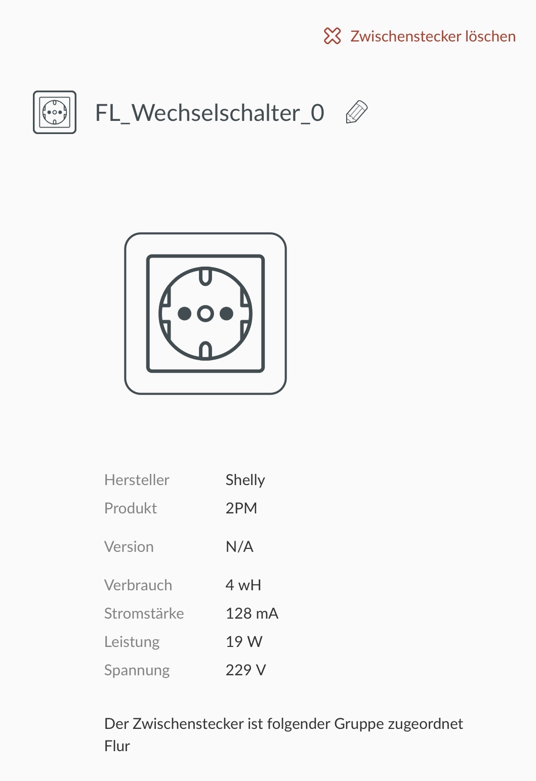

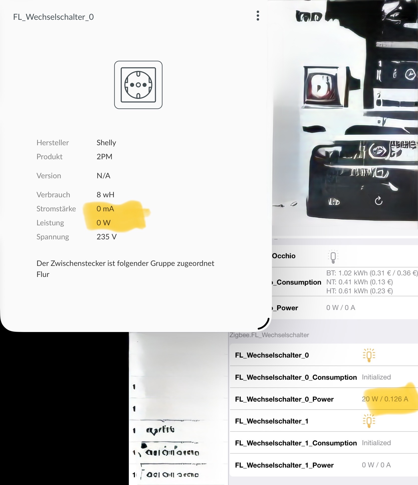

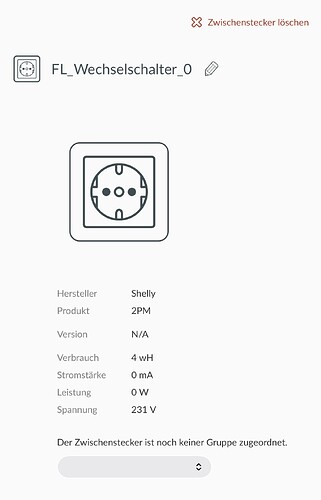

No, not everything is working.
The consumption is displayed for a short time and then switch back to “0”.
It’s the device that work in wifi and zigbee mode ? You have good value in wifi but 0 in zigbee ?
Can come from the hardware, but I don’t found the issue about it, IDK if they have updated their fiwmare since last time.

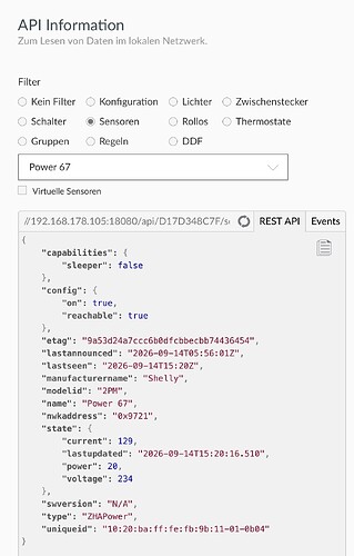

The deconz GUI displays already „0“, but the API Information has the right value.
I’m useing FHEM, and the correct value is displayed there. At the same time, it is incorrect in Phoscon.
//Edit: FHEM useing the API to Phoscon
In same time ? If I remember the value can be good but return to 0 fastly.
But if it’s fine in the API, it’s fine for me, it mean all third app can get the good value, IDK what is doing Phoscon.
Yes, at exactly the same time.
It doesn’t matter – FHEM works with it.
