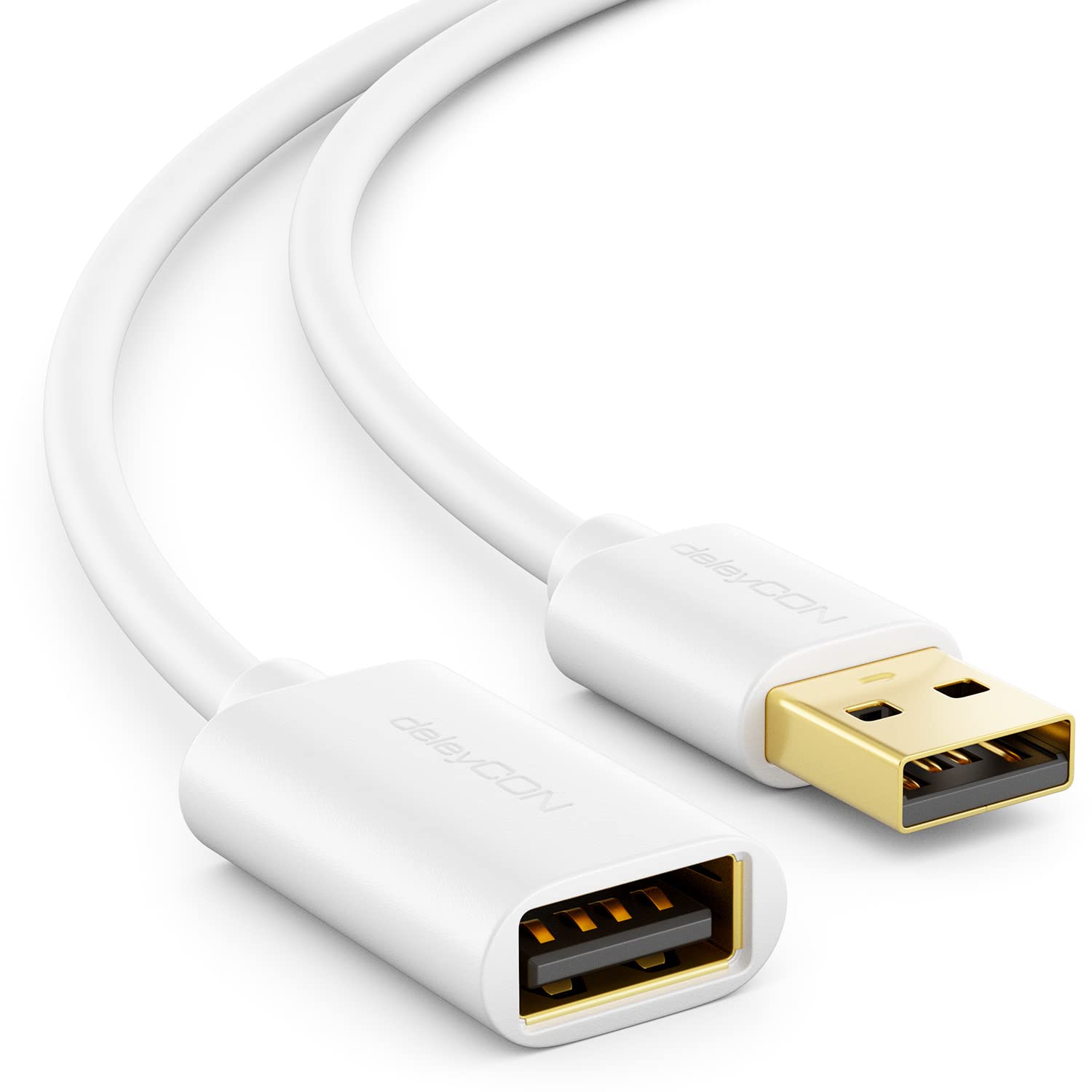

- I’ve tried various lenght of usb extender
- Both ssd and deconz are connected to USB 2 and there’s nothing on USB 3
