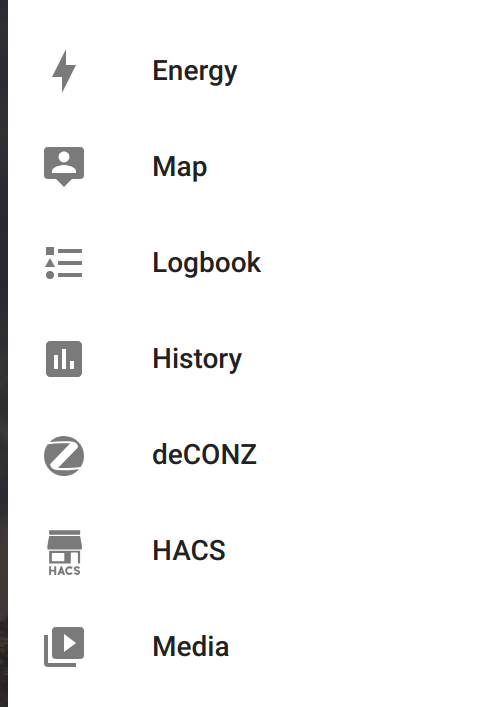

if you enable the sidebar icon on the HA deconz addon,
you can then access phoscon by clicking on that sidebar icon.
Have you tried that? Don’t know how it works internally (ingress and so on), but that is what it should still work, and be able to login, and see the gateway page (not blank).
Maybe I am stating the obvious and that’s what you are doing already, wanted to be sure :slight_smile:
