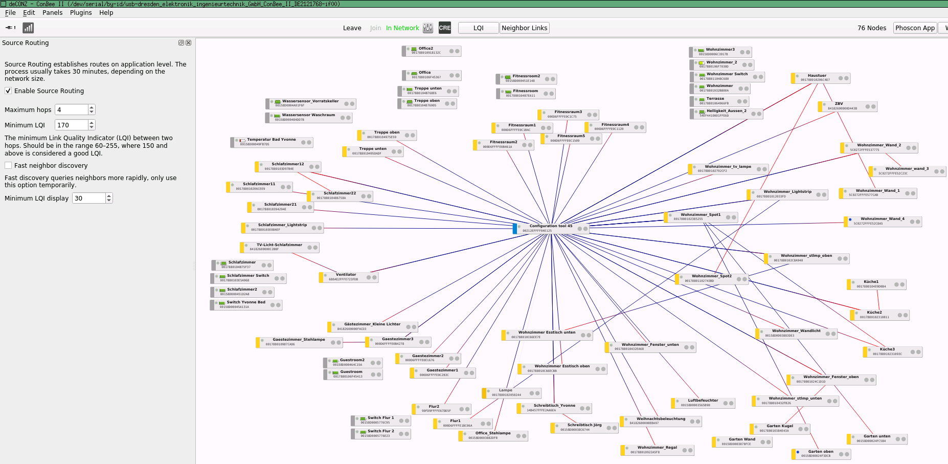

How many sensors and routers do you have? Sensors are battery powered devices, routers are mains powered devices.
Also, can you share a screenshot of your deCONZ gui?
There are 51 powerd devices and 22 unpowered
By the way, I deactivated the link printing because it cost 4 to 5% CPU use.
But nearly all of my links are green and a few are yellow.
I have an excellent network and no issues with that. All devices working rock solid
Seems good to me.
