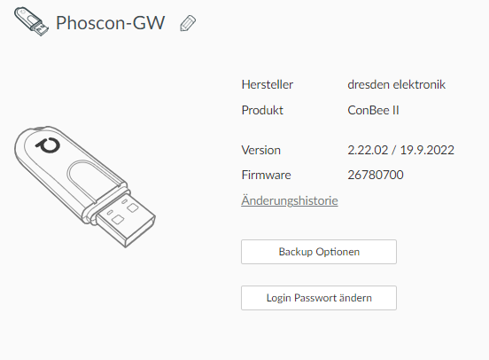

Hi Manup,
this is my version:

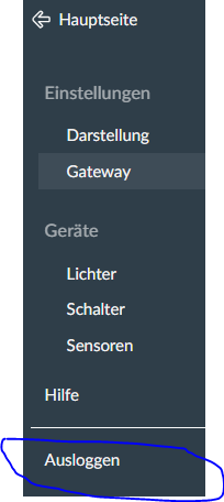

When you say leave and join, what do you mean with that?
This?
If yes, done that more then once
You need to use deCONZ, not Phoscon.
