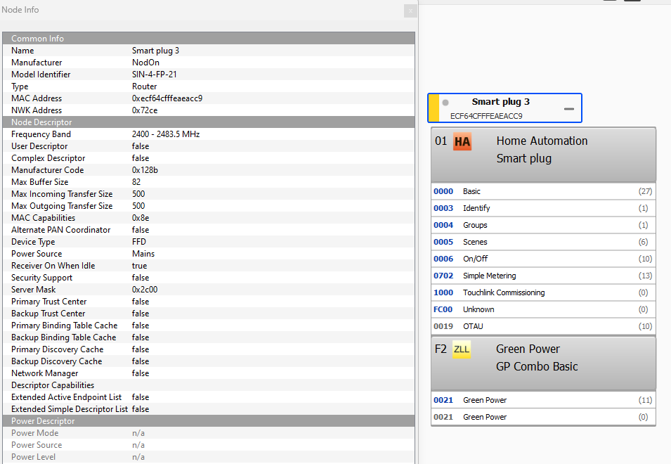

Hello is it possible tu use Legrand cable outlet ‘wire pilot’ with Nodon SIN-4-FP-21.
The two products have the same use, they are modules for managing electric radiators with the French ‘Pilot wire’ standard. The orders are start, stop, eco, eco -1… exactly same as Legrand. Is there the possibility of having a json or a DDF file extracted from the legrand 199143 device or equivalent?
I think that many French users are waiting for the SIN-4-FP-21 NodOn module to be supported by Deconz. I control my home automation in PHP, by writing a small API between my PHP and the rest server. Your conBee key is the only one capable of supporting a very light system without using home assistant, jedoom, domotic etc…

I already have some information but to respect the procedure can you start a Request Device Support · dresden-elektronik/deconz-rest-plugin Wiki · GitHub
I tried, followed the link, opened a pull request. I validated and it doesn’t appear anywhere.
How to do it?
IDK, if something have failed you need to have an error message, open at least a new topic, to not pollute this one.
And you can start with this DDF

IDK how you switch from fil pilotemode/ON+OFF so the DDF support both.
Ok, here NODON fil pilote SIN-4-FP-21
