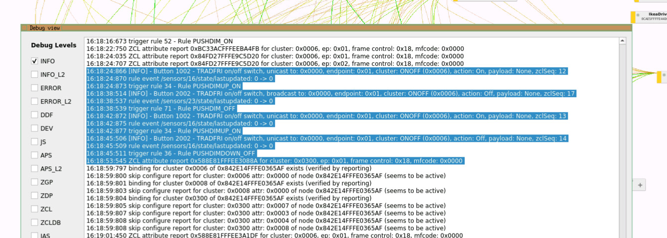

The switch that triggers all light (only in ui but some for real) seems to broadcast and not unicast…
sensor16 is working as expected,
sensor23 not, unicast, any idea what i can do?
tried to delete the group that was created for the sensor23 (sensor16 does not have one) but still triggers too much…

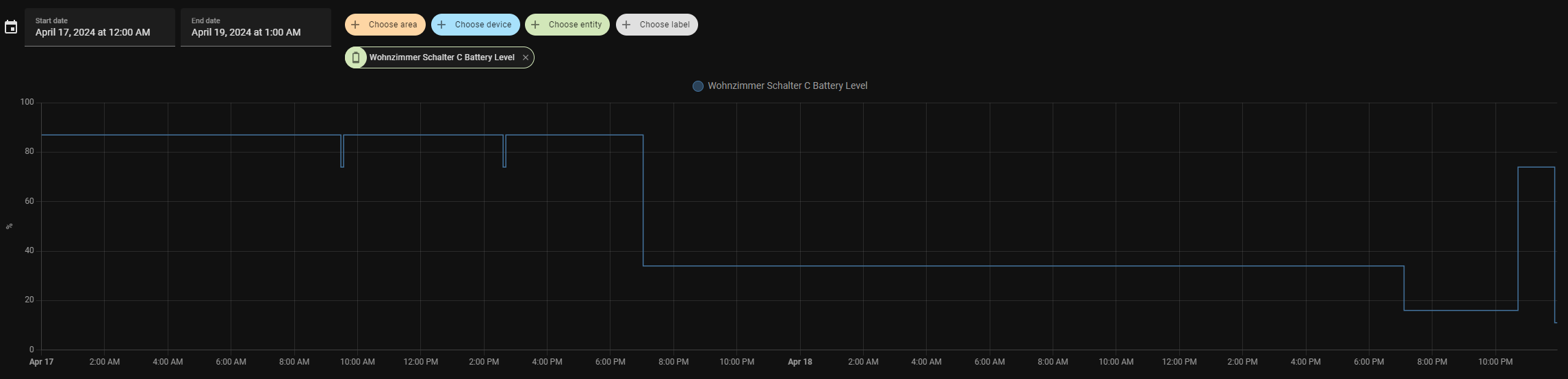

Here is the battery drain of one of my switches
Jumpy but down to 11% after 2 days
Just installed the new firmware, and also a new battery in this switch
Will report in 2-3 days.
Short update: battery of the switches looks good so far after upgrading to the pre release.
