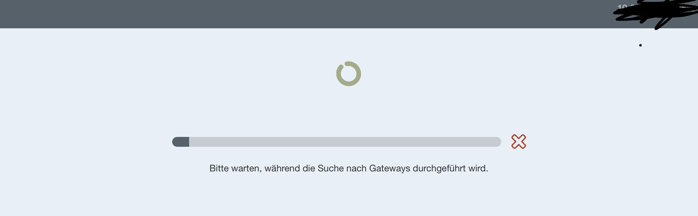

Until a few days ago, I could simply connect to the gateway via app. Now, unfortunately, no more. At https://phoscon.de/discover I only get “[ ]” back. Any idea?

No, put in /pwa.
Did you try another browser / device?
Additionally what did you change prior this happening ?
Yes. Chrome, Firefox, Safari. MacOS, iOS, Android
Did you try the local ip + pwa on another browser ?
Yes, of course
