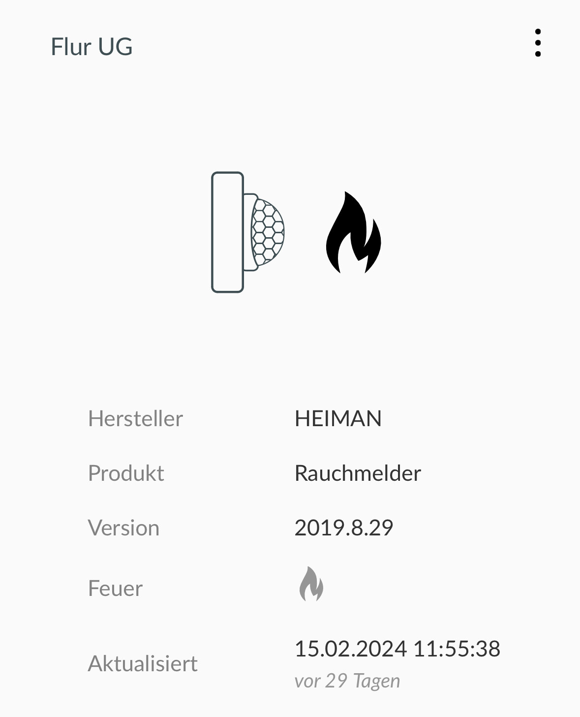

This is how it looks in Phoscon:
It was most probably the day where I last made a test alarm. But I would expect that the date is today where I exchanged the battery. Or any other newer point afterwards. The sensors seem to send updates quite regular, about once in an hour. All other sensors I have ( water leak, door/window, gas) usually have a last update in the range of the last hour.
Everything is fully within expectations, lastseen != lastupdated
Lastseen is current, as the device constantly communicates, lastupdated was apparently the time (as you already guessed) the time of your test alert. Note that it is within the state and therefore only applies to it.
Okay thanks. I keep monitoring it.

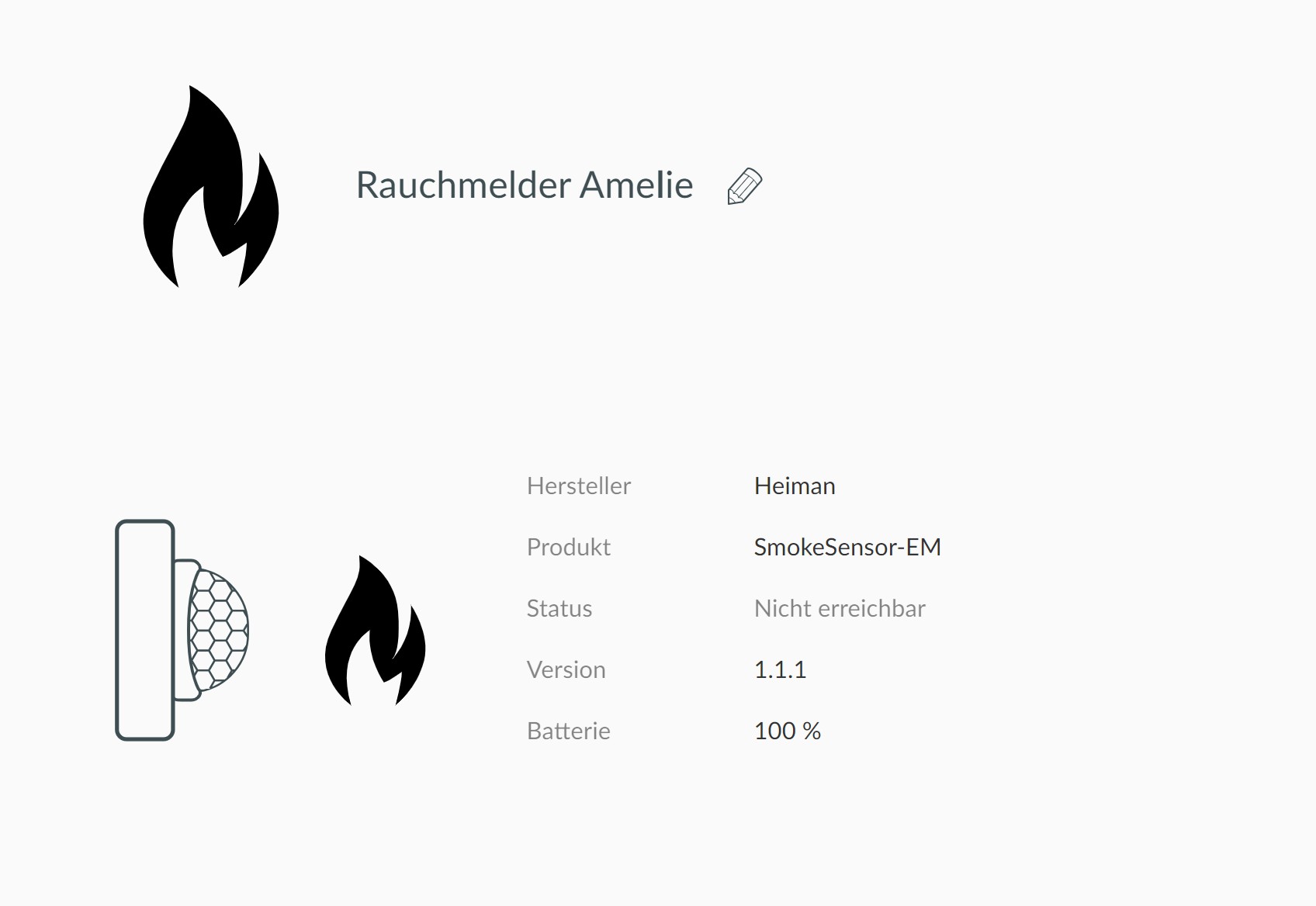

I have a similar/same problem with these smoke sensors. I have 6 sensors. and 2 of them are always not connected. I tried to reconnect (delete them and learned them again) but nothing happend.
    "battery": 100,
    "enrolled": 0,
    "pending": [],
    "reachable": false

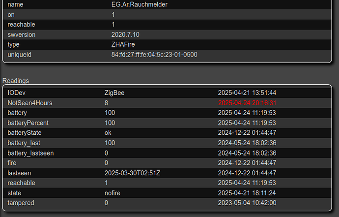

fhem rest-api access battery state gets not updated
After posting the jsons for the 3 sensors… I was wondering
I checked the other sensors, too.
The result was that every sensor has lastseen timestamps not older than 3-5 hours. If I check them with the api tool.
So my problem seems to be according to the log, that the websocket notification gets not generated only for the smoke sensors and only for other computers than the one fhem and deconz are running on?
I checked my config but:
"websocketnotifyall": true,
Is this possible? How to solve?
Thanks

Lastseen gets not refreshed on the fhem side - although rest-api did send correct data.
BUT Only for the smoke sensors!
Heiman GASSensor-EM for example makes all the refreshing of all values even lastseen. Real strange - can’t find the difference.
