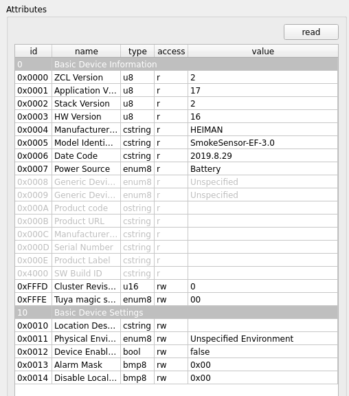

I donât found capture from the cluster 0x0001 for this device.

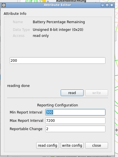

Can you take a look to see if the attribute 0x0021 is working ?
What do you mean with âworkingâ? In my case it has a value of 200 and this value is never changed/updated
Same here.

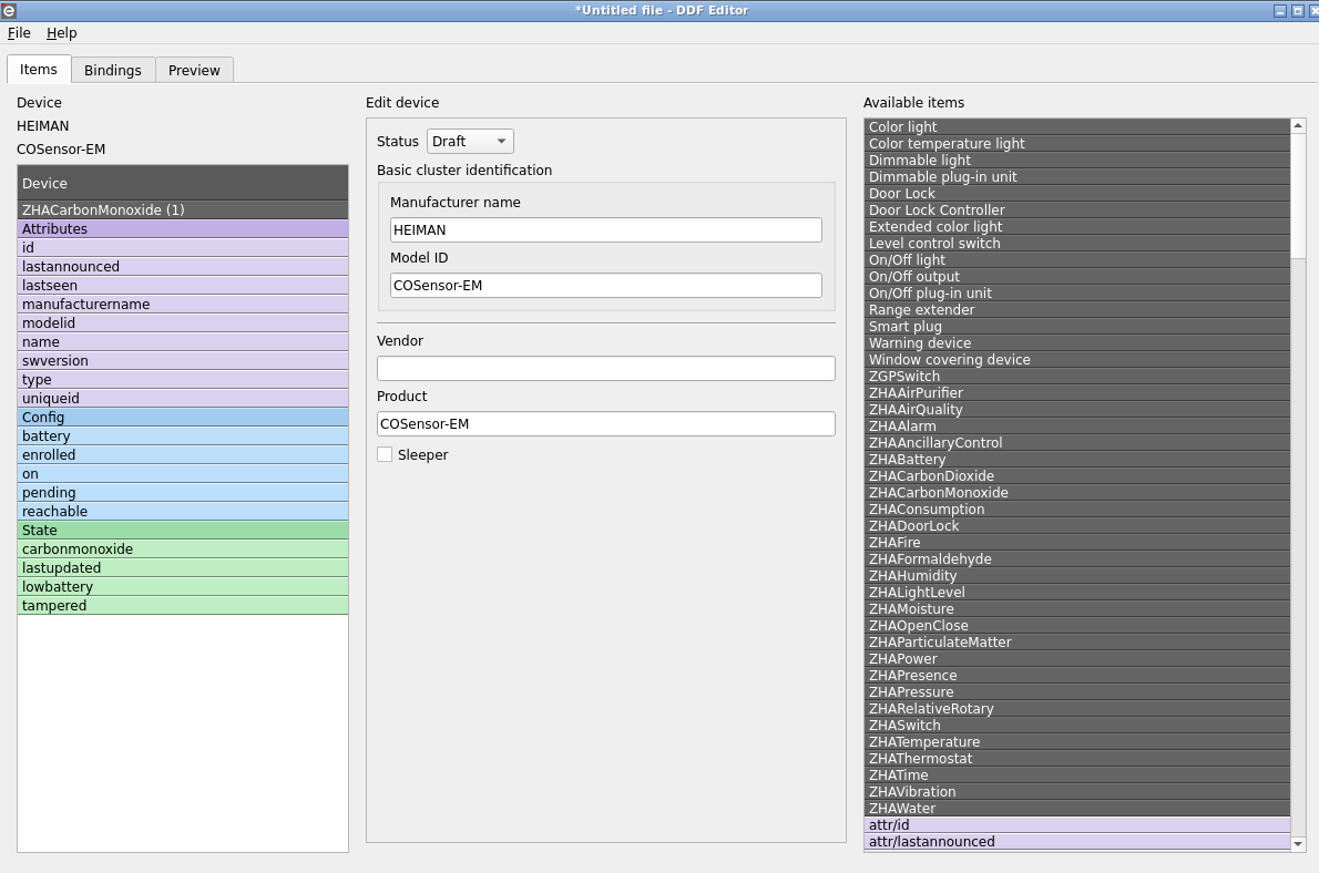

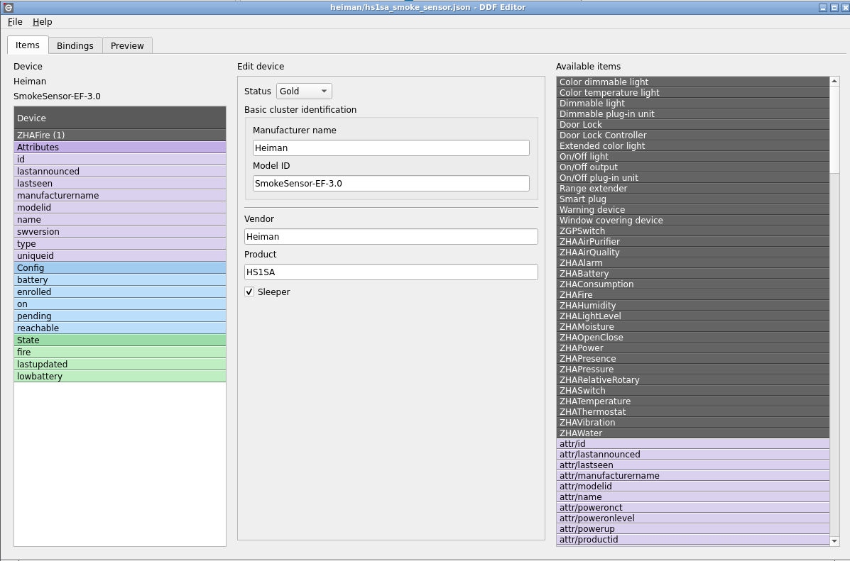

I just compared the DDF of the Heiman smoke sensor with a Heiman carbon monoxide sensor I have too. The battery of the CO sensor gets updated correctly, also pushing the test button gets transmitted correctly. The CO sensor uses this DDF
First thing I noticed is that it is not checked as sleeper, even though it is one. Then there are some differenced in the battery part of the DDFs, but Iâm a beginner in DDFs, I hope someone of you looks at it and says BINGO ![]()

If you double clic on the attribute and press read, it will update the value (the device need to be awaked in same time), it will update too the value in the API in same time, so you can see if it update the status.
Perhaps this attribute is not working on the device, but from what I m reading on Z2M, it need to work like other device.

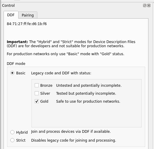

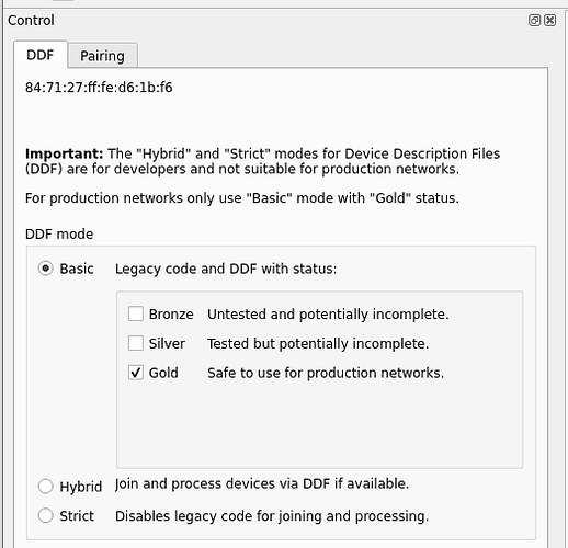

@cosmo84 the DDF on your capture is not used âDraft statusâ.
This device donât use DDF it use native/legacy code.
I took one sensor and made it awake, then read the battery but it remains at 200. It says âreading doneâ, so it was successful, but without any change to the value. As said, quite impossible for a 2,5 year old battery to be still at 100%.
But itâs from the device itself, else you will have an error message, and this value is updated or grayed, so itâs not a previous memorised one.
