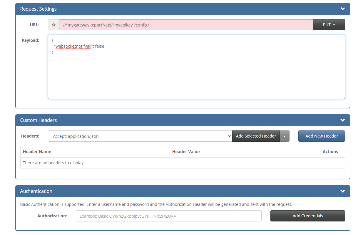

Can use direclty the API Introduction - deCONZ REST-API
or Curl with something like
curl -H 'Content-Type: application/json' -X PUT -d '{"websocketnotifyall": false}' http://IP:PORT/api/KEY/config
IP and PÖRT are the same used for phoscon, and KEY can be the same API key used for jeedom.

I don’t use postman very well. It’s a new world for me.

Ok so if I understant I have to made that :
Because I think it’s OK :slight_smile:
But nothing change on the disk write
Yep it s exactly that.
This options decrease websocket notification, you will have one ONLY if there is a change.
But if nothing change, I m out of idea, can you show the same logs than before with this option enabled ?
