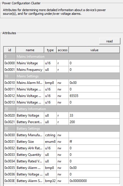

Cluster information shows also a value for moisture now (446):
However, I do not see moisture (-0408) in Phosconn App and (therefore?) not in openhab. The other channels (-0400, -0402, -0403, -0405) are shown in both. But those values are not measured.

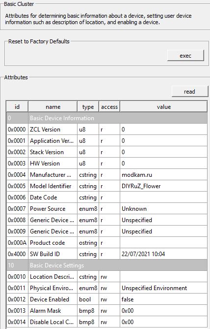

Basic:
Power:
The others (pressure, humidity, …) do show 0 only as they are not measured. I guess this is not interesting for you, right?
