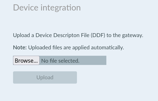

Thanks, you can also install the new DDF with the fix in current versions by downloading following zip file https://github.com/dresden-elektronik/deconz-rest-plugin/actions/runs/13766572214/artifacts/2722631138
And upload it in the Phoscon App under “menu → Device integration”
(might need to restart deCONZ after that to make it pickup the new DDF)

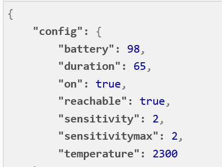

Edit: Not sure if this is really solved. A few hours later (had the Phoscon API tab still opened) I refreshed the sensor and well… where there was a "sensitivity": 0, before, now there’s (again) a…
I did not restart deCONZ yet.

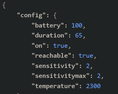

For me it did not. I set the sensitivity, confirm the new one is accepted checking via API Information and trigger the vibration sensor (I don’t need to push the physical button on the sensor right?). Later on (don’t know how long it takes, e. g. I set it yesterday evening and checked it now): back to normal:
I set it to 0, now it’s 2 again. For me nothing has changed after importing the DDF.

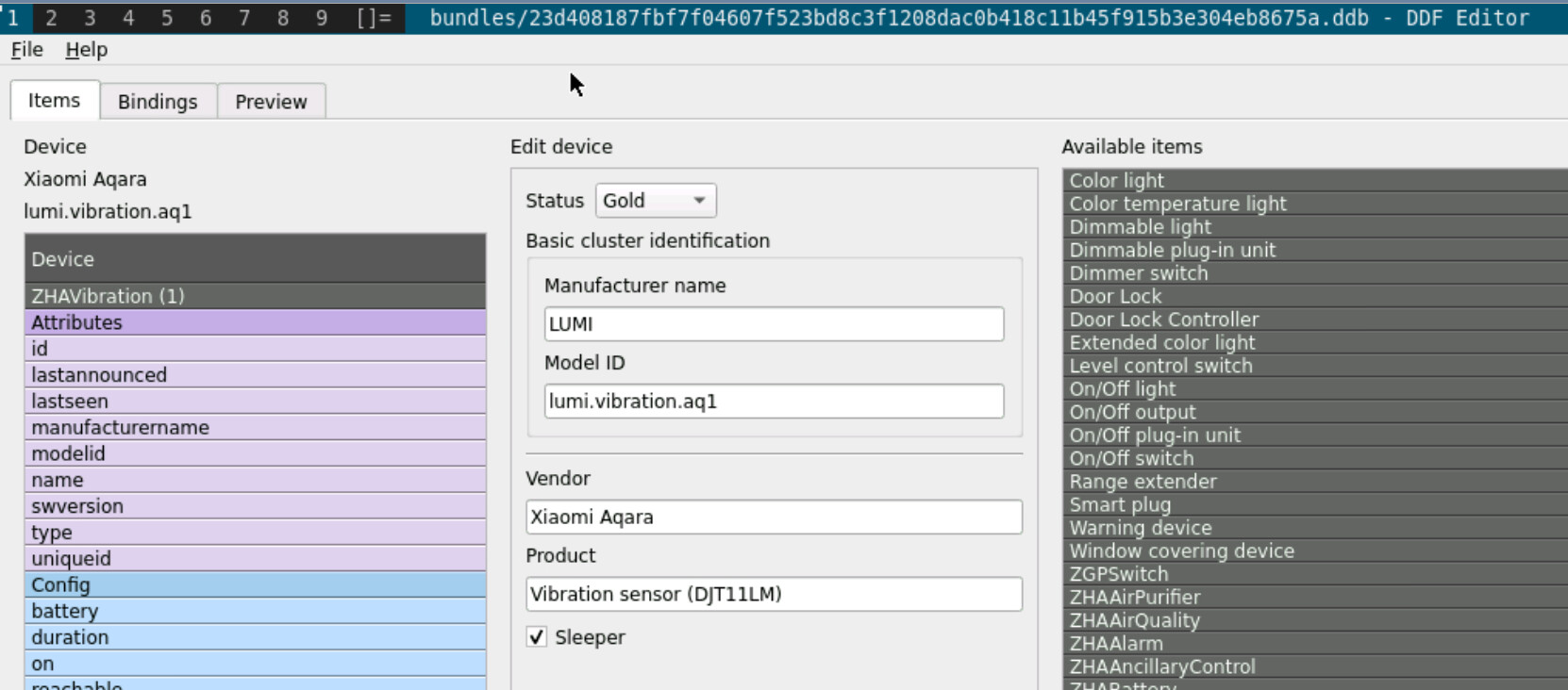

When checking the DDF vor a affected vibration sensor, I get this:
Does the filename (/bundles/................ddb) match the manually imported DDF file? That’s the first thing I wanted to check.
Updated deCONZ to latest v2.29.5 yesterday and therefore restarted the addon/container. Sensitivity seems to be stable now (finally accepted the DDF I guess, shipped with stable).
BUT now…:
