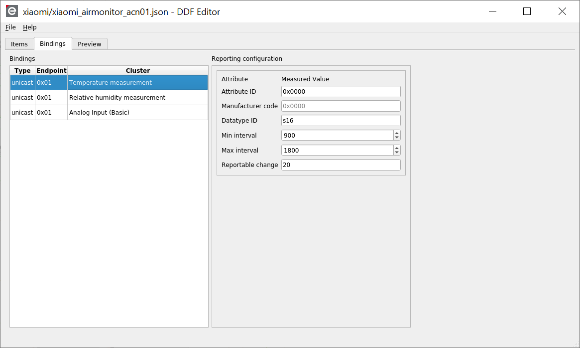

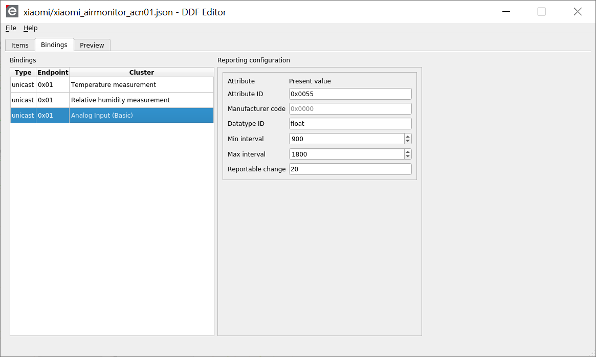

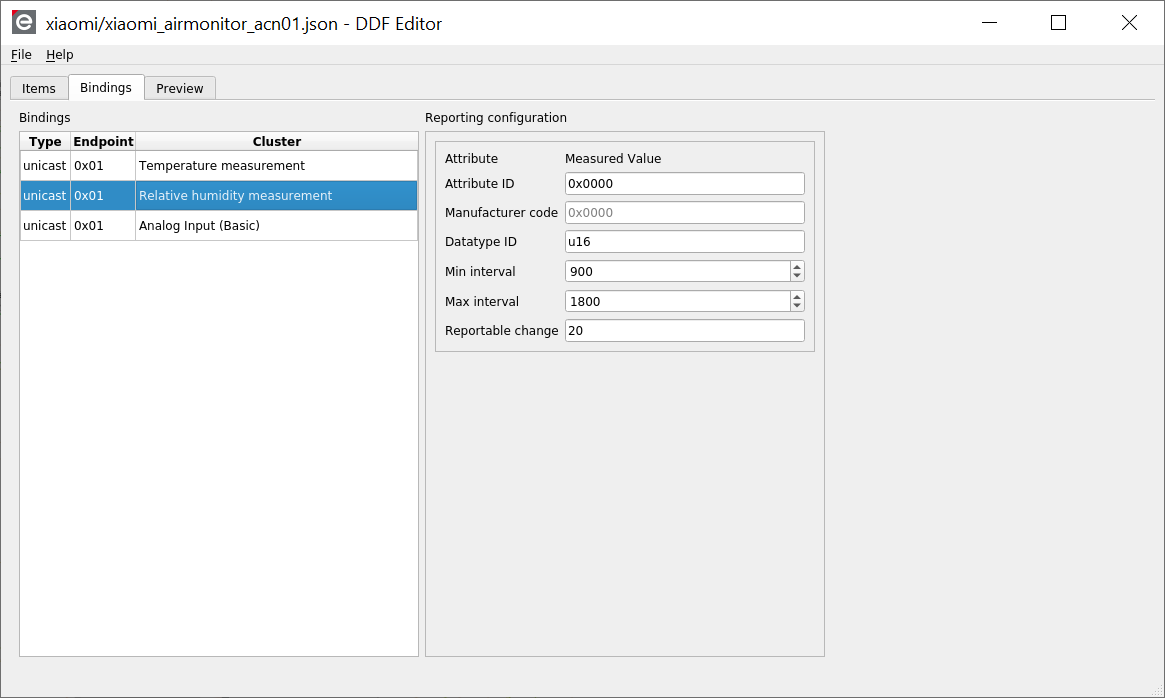

I added the bindings for all 3 measurements to the DDF:
It looks good. I have a AirQuality measurements every 15 minutes.
I still don’t really get what “Reportable change” is and what 20 means…

It’s the minimum difference value you need to have to trigger a report, for exemple if the previous values for temperature was 2200, you will have a report when the value became 2220.

Ah, so 20 makes sense for temperature and humidity (0,2° / 0,2 % change). But what about the airqualityppb? better to use 1?

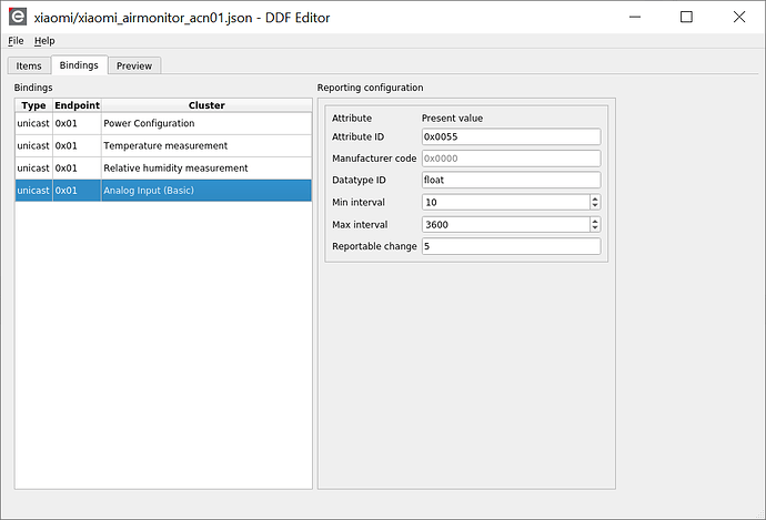

Im looking on z2m code
There setting a bind for temperature/humidity/powerconfig and Analog input
For the analog input it seem they are using 10/3600/5
I updated the DDF to

For power Configuration deconz use 300/2700/1

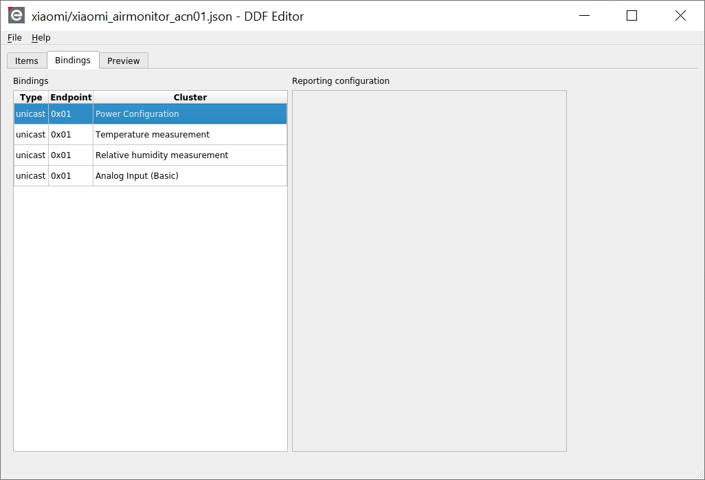

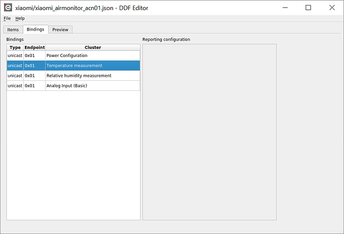

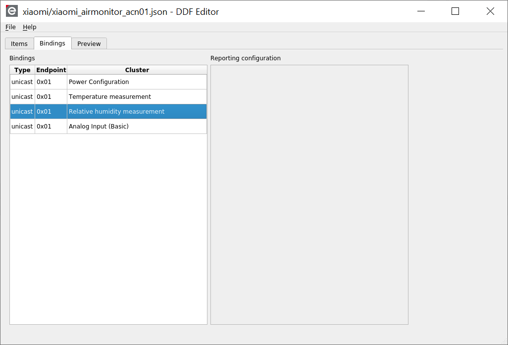

Should I set the bindings via bindings tab or DDF Editor?
I think DDF editor is better, with status gold and “hot reload”.
The DDF binding overwrite the binding from deconz.
As battery sensor are slepping, more boring to configure, need to use a queue list, perhaps can be better if you re-include the device.

…but stopped since then. No success :frowning:
Peut etre des infos ici Aqara TVOC sensor (VOCKQJK11LM) stops updating · Issue #9454 · Koenkk/zigbee2mqtt · GitHub
Let’s see…

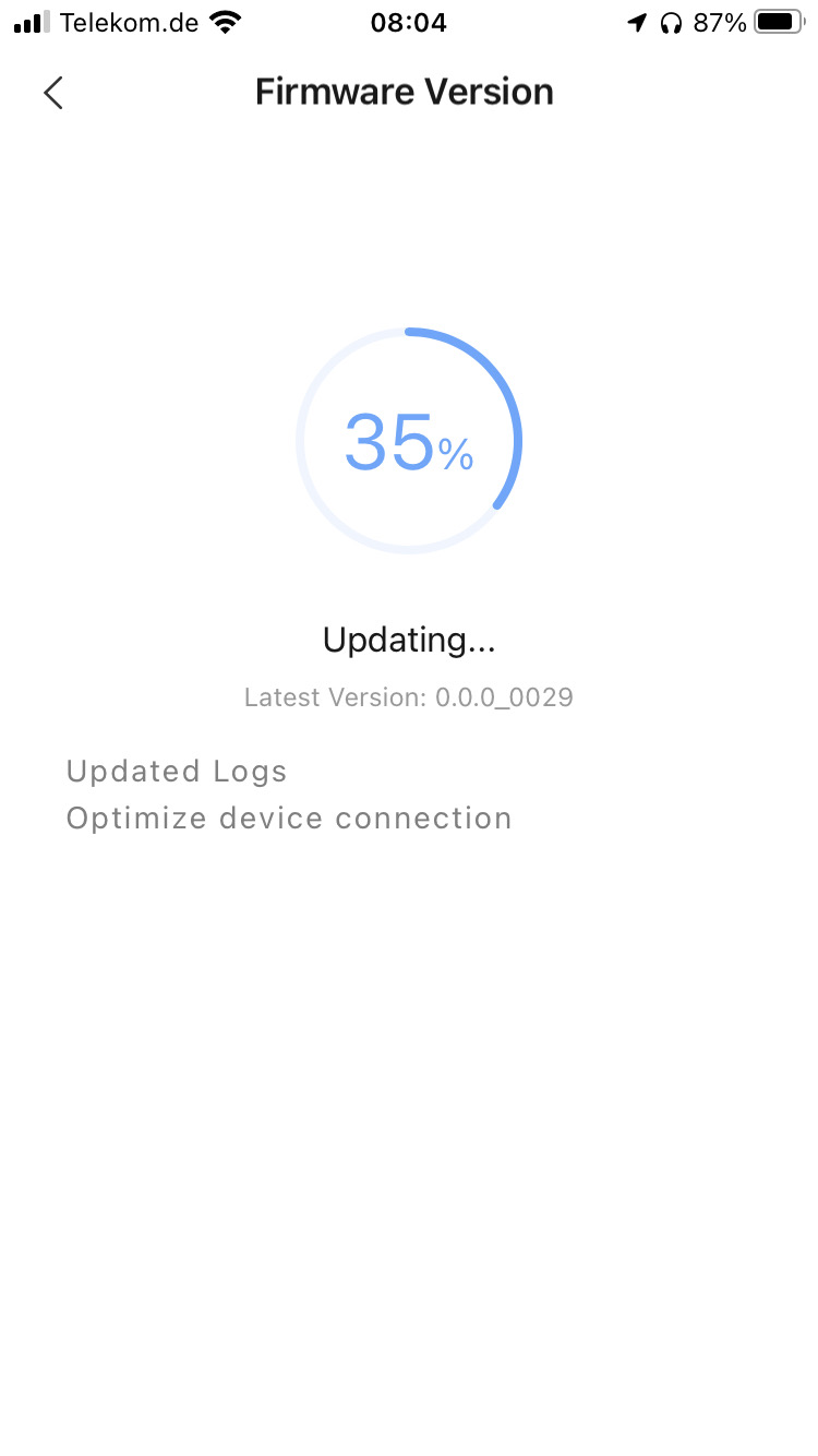

So I updated to 0.0.0_0029 on friday and re-paired it to deconz. No success, same as before: a few updates, then nothing.
So I did the binding via the binding dropbox to see if this changes something. And i looked really good: I had one update every 15 minutes from this time (friday ~10:00)… until this happened on sunday:

I changed the batteries after the update btw.

So it work if you make the bind using the GUI but not using DDF ?
(On the GUI you make just the bind not the reporting ?)
Gui, Bindung + reporting. Works, but only for 2 days
