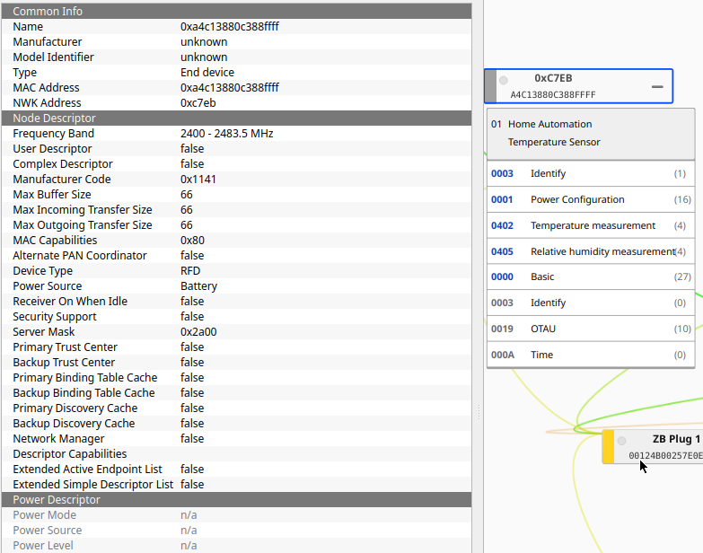

I guess this is yet another TS0201 variant. Box is labelled UZ-1T. I have it paired.
I see Wing TS0201 is added here:
so I have just dropped that in to /usr/share/deCONZ/devices/tuya/ on top of the original , this should work, right?
But after restarting deCONZ it still looks the same, like it doesn’t know what it is.
Actually maybe I posted a bit quick, it has appeared in the web app now, although the values are 0 even though in deCONZ it shows 2300 [ie, 23°C, which seems reasonable]. Will give it some more time.
We need the model id and the manufacture name of the actual device to be sure, from deconz.
On the DDF you need to add them (both) but after have see them in deconz, it’s tuya, so much clone, no way to be sure.
Is all OK now, showing temps in web app and HA.
So yeah, pulling in the new DDF and restarting is all that was required to get this online.

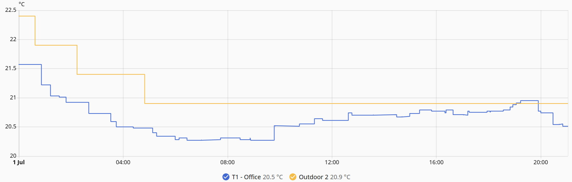

So what do we think of these cheapo sensors? I have it sat next to an Aqara sensor [“Office”] for the past 24h. Every time I look, “Updated” is within the past 5 minutes. Yet readings rarely change.
      "at": "0x0000",
      "dt": "0x29",
      "min": 60,
      "max": 600,
      "change": "0x0000001E"
With setting from DDF it need to be updated every 0.3°C the device can not support them ?
