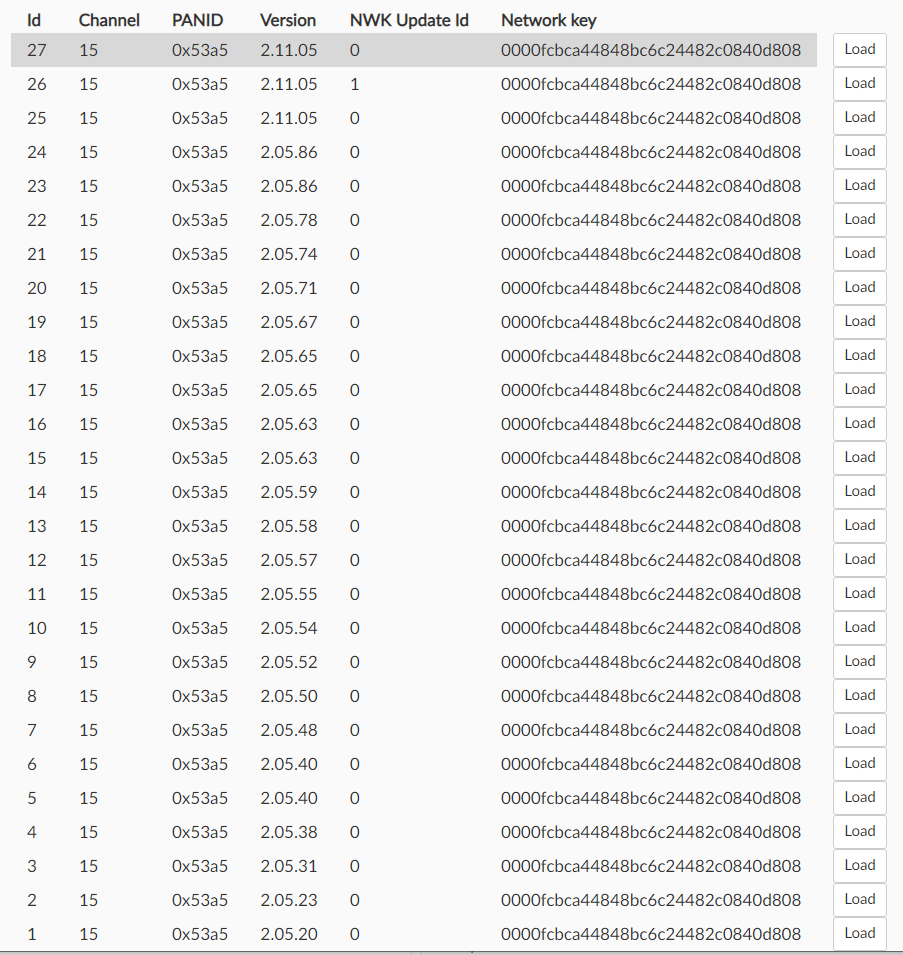

Screenshots

The state did change. Now deconz is “painting” green lines to approximately to roughly 13 of my 60 nodes compared to seven before the extension cord.
But still no meshing (green lines) between mains connected nodes.
