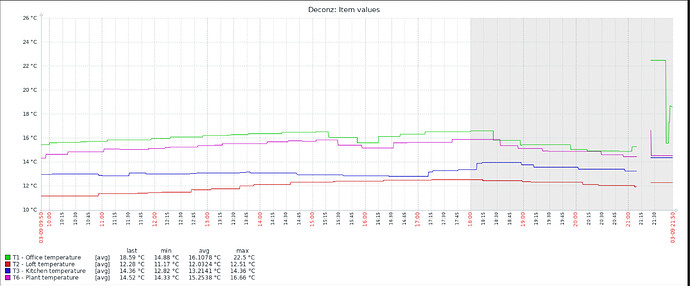

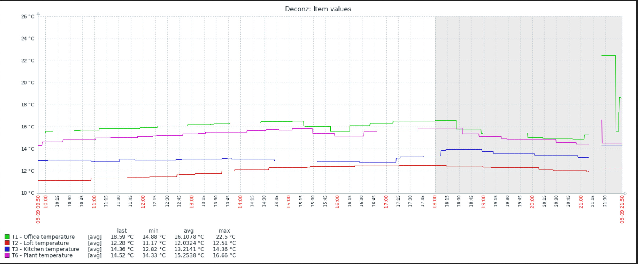

If I restart deCONZ [because of issues with Home Assistant, see other threads], the temperatures jump around implausibly:
Every temperature has suddenly jumped. The pressure and humidity behave the same.
Is this likely to be a deCONZ issue, or is it the sensors?

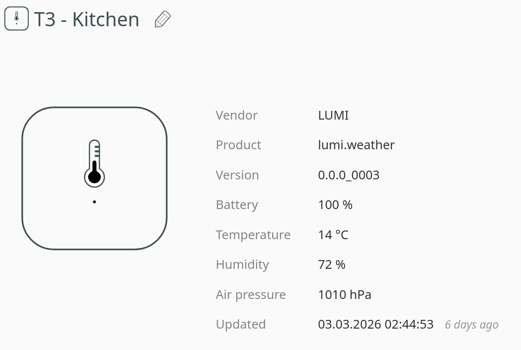

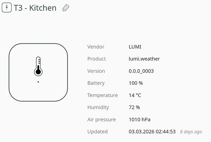

Odder still, in the PWA, Kitchen is showing as 14°C, which is higher than expected from the above trend, but Updated is from 6 days ago? Doesn’t make sense.
You need a new battery.
On all of them?
Aqara/Xiaomi device make report every hours maximum, so 6 days without report generaly mean battery issue.
I don’t think it’s a connexion issue else the device will be grayed and marked as unreachable.
But yes the jump is strange ^^.
Devices can take 1 hours before making their first real report (if temperature don’t move), idk what is the defaut value at start. But it’s strange you have all sensors starting to send report at exaclty same time, around 21h20, for me it’s not real reports.
Perhaps it’s not clear, but it’s nonsense, it was definitely reporting data because I am polling it from deCONZ API with Zabbix, this is in the graph.

And looking your graph, the green line go to 23°C at restart, long time you haven’t this value, IDK why deconz have stored this one.

But I have another question, if value are changing, why the last updated date is 6 days …
Can you share the complete device json ?

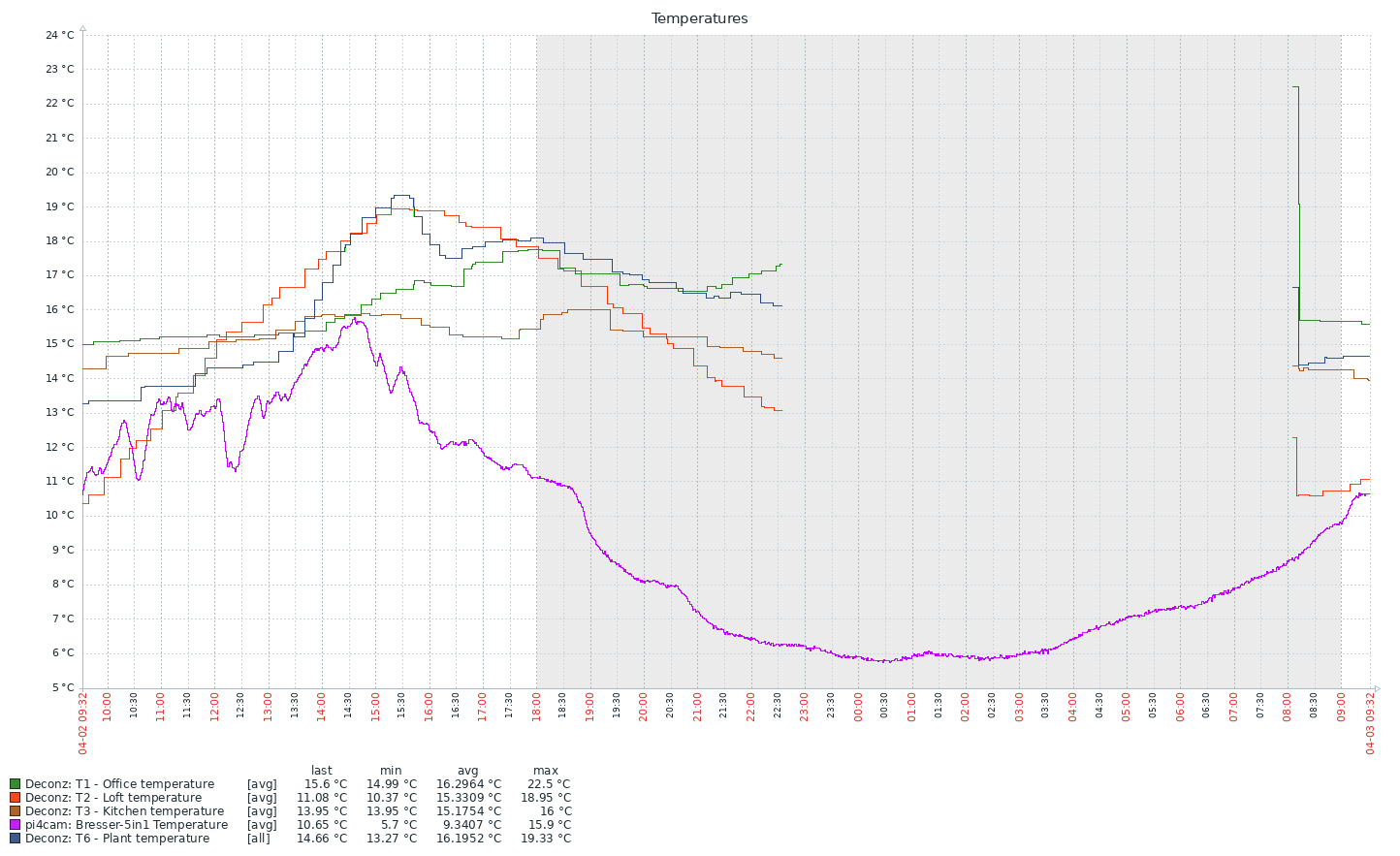

Had to restart deCONZ because it crashed when Home Assistant was restarted and again there is a spike in values:
If this is some “cached” value then it is from some time last year, my office has not been 22°C for at least 6 months.
And if I m right it’s exaclty same valued after the crash than on your previous capture (the first post) ?

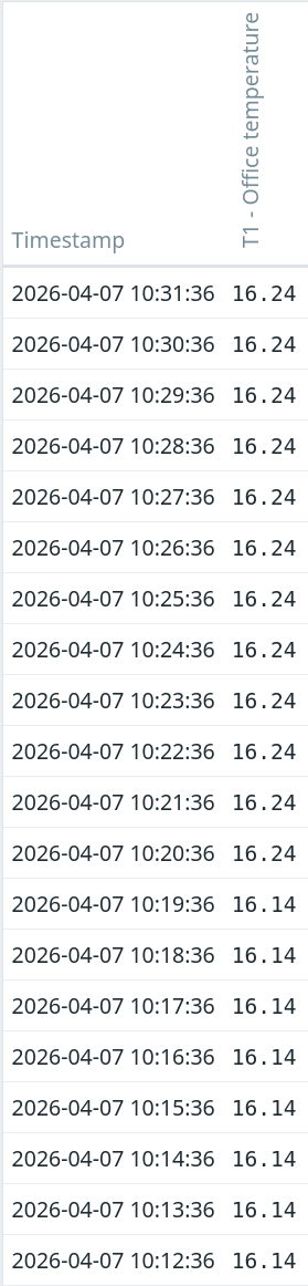

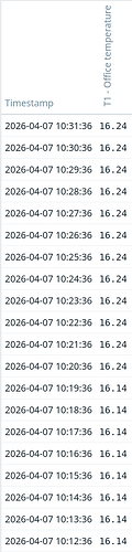

Timestamp on zll.db is from 4 minutes ago. If that “lastupdated” is to be believed then this is from last week.
Values polled from API
I have not seen 15.9 today. So it really looks like the database is not up to date and I would not be surprised that if I were to crash deCONZ by restarting the Home Assistant container then I would get 15.9 with the API.
