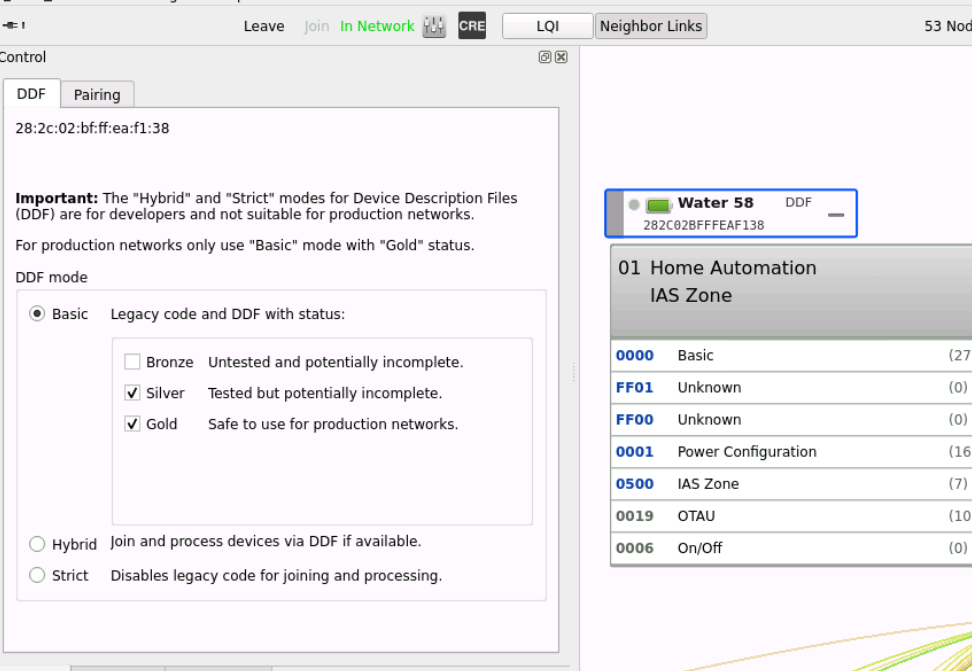

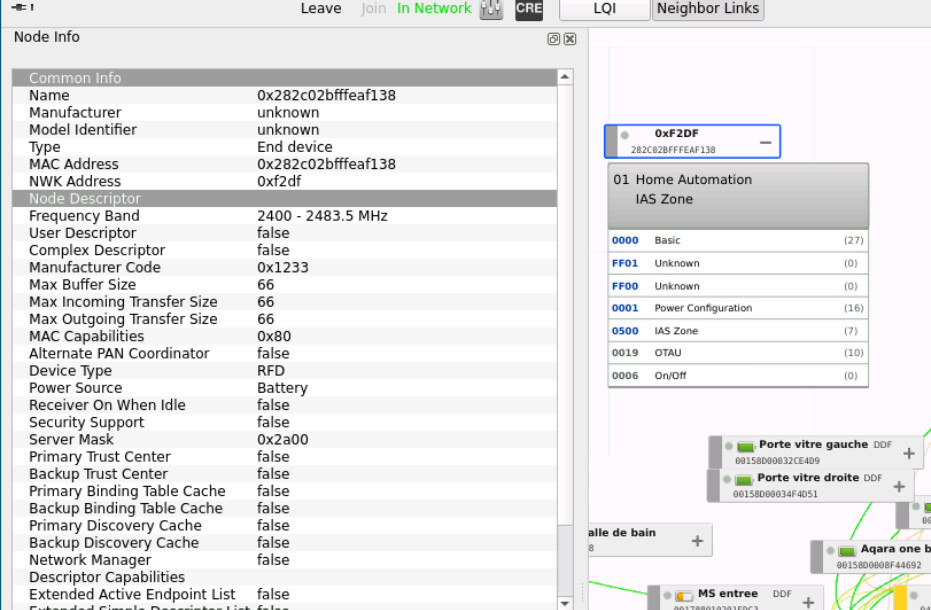

Hi there,
I try to add the THIRDREALITY Water leak sensor 3RWS18BZ to Phoscon in sensor but i cannot pair it. The sensor stops blinking blue after couple of seconds but nothing show in Phoscon.
According to ThirdReality Water Leak Sensor - 3RWS18BZ · Issue #5682 · dresden-elektronik/deconz-rest-plugin · GitHub, it was added back in 2022. My Deconz version is 2.28.1
Does anyone use it ? do you have any idea or should i post it on Github ?
Came accros the same behavior as justin-caldicott here THIRDREALITY Zigbee Motion Sensor, Pet Friendly 3RMS16BZ · Issue #5337 · dresden-elektronik/deconz-rest-plugin · GitHub
Thanks
