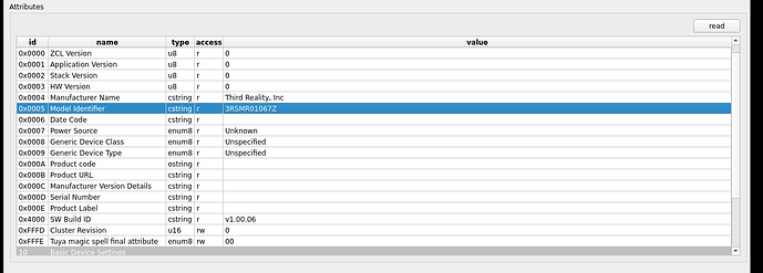

In Deconz Gui I have this:
Third Reality, Inc as manufacturer.
Should I add modify the provided DDF with these info? Thanks
Yep try adding your model, Manufcture name AND model ID.

  "manufacturername": ["Third Reality, Inc", "Third Reality, Inc"],
  "modelid": ["3RMS16BZ", "3RSMR01067Z"],
I created a specific DDF and it’s working, thanks! Should I upload it somewhere?
