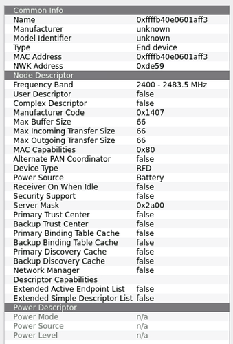

I have attached some screenshots from inside Deconz.
Hope this helps.

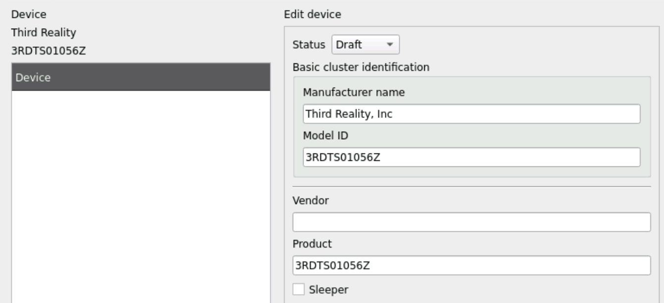

This device is already supported, check your deconz version
  "manufacturername": [
    "Third Reality, Inc",
  "modelid": [
    "3RDS17BZ",
    "3RDTS01056Z"
