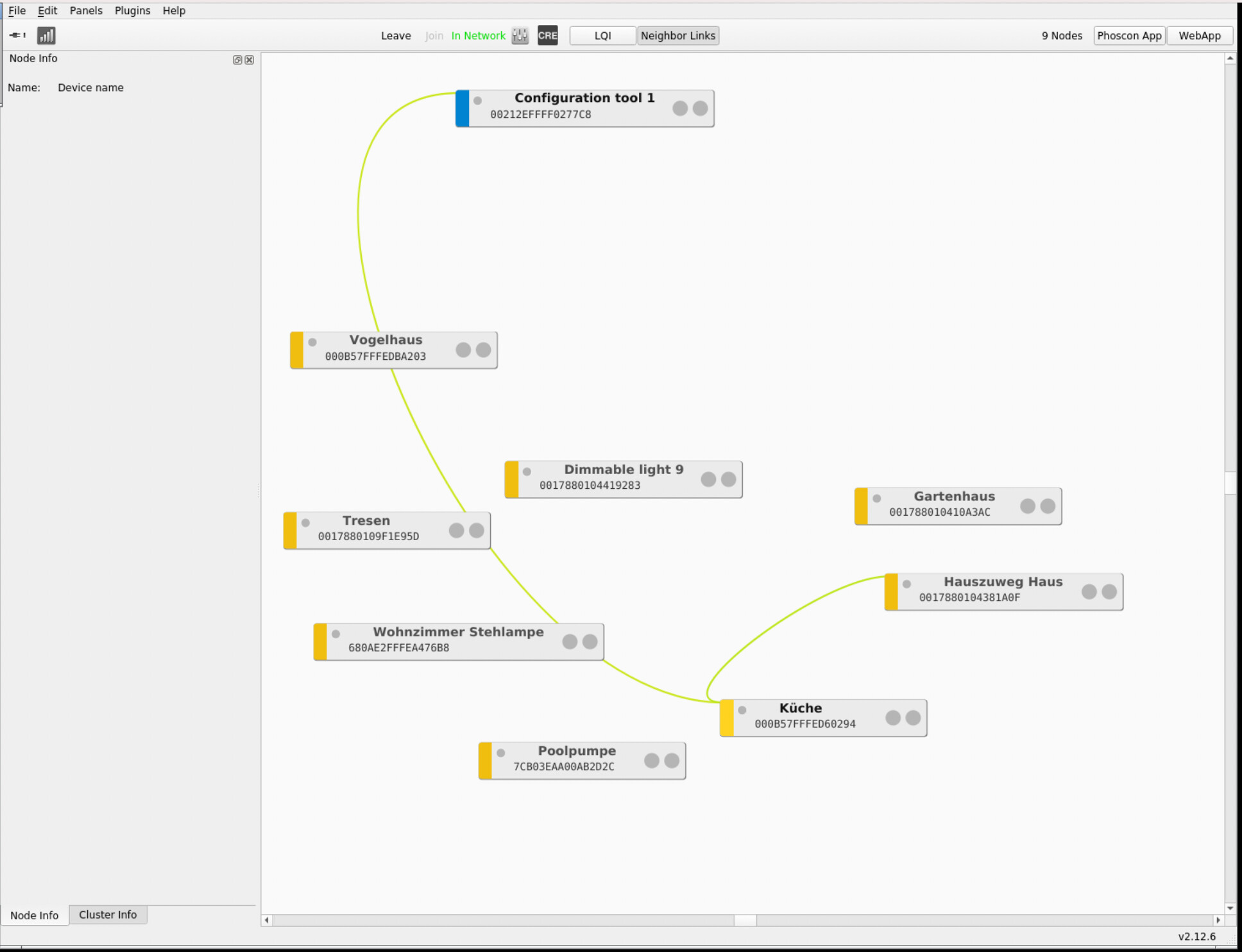

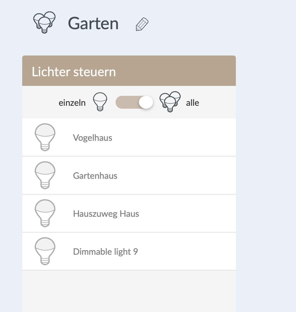

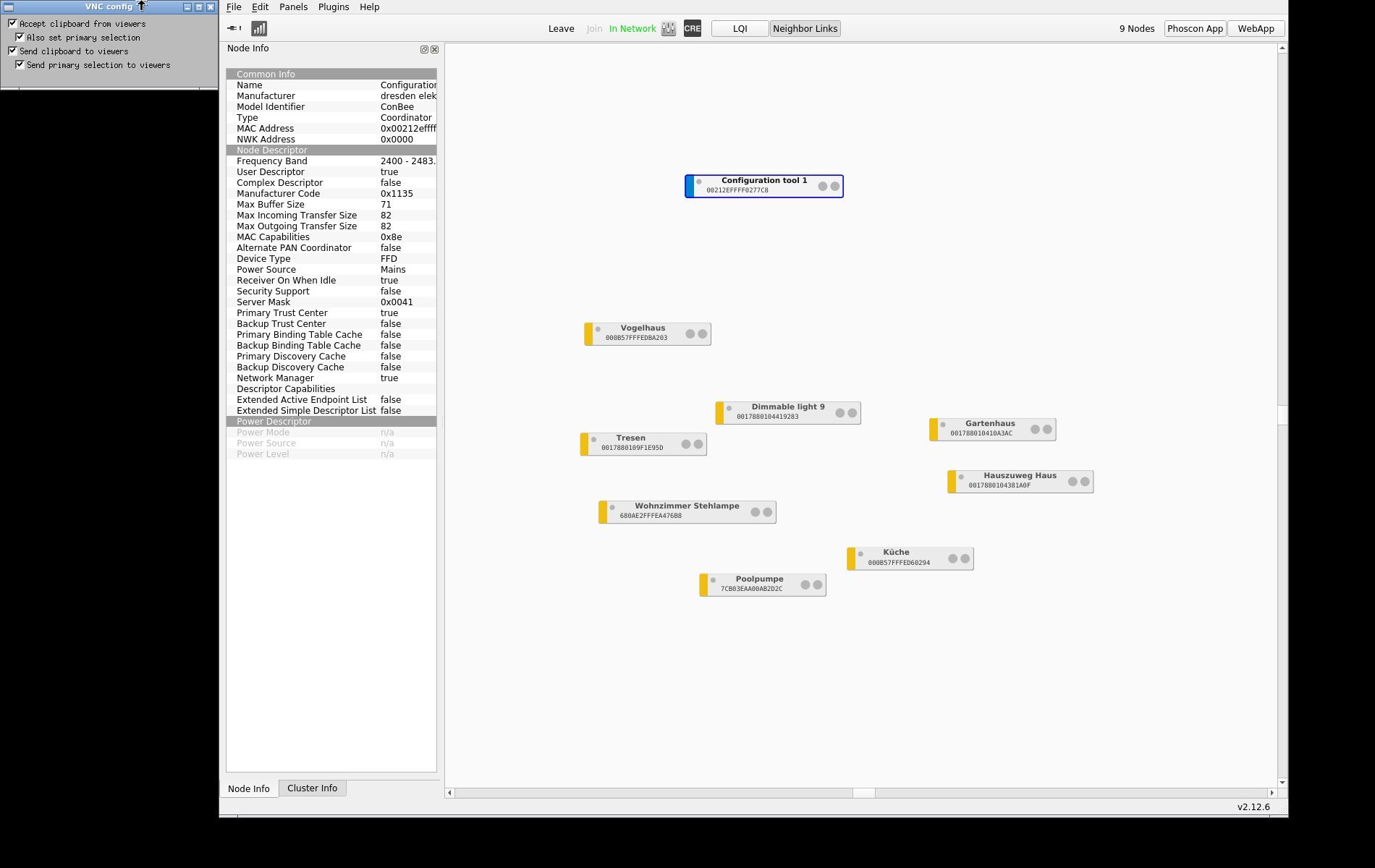

suddenly all my devices got grey in phoscon app an in the deconz-gui there is no mesh neither no line between the links anymore.
I tried a firmware update, I tried to leave and join the network more than twice. Several reboot are made and the lights are powered of and on but the device still does not appear again.
Could you please help me?

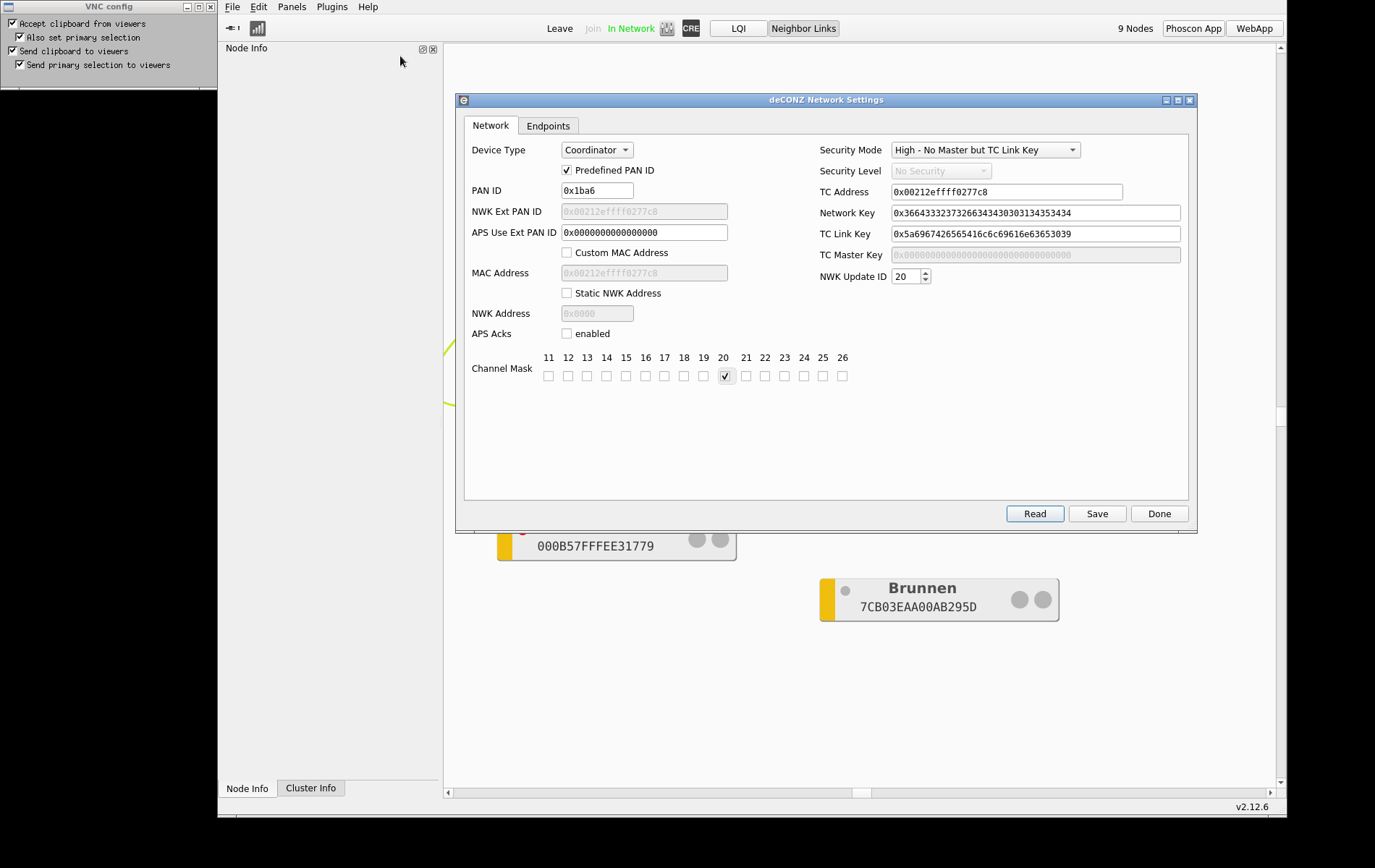

Can you show the deconz setting panel (F9 key) ?

First the Screenshot of the setting panel:

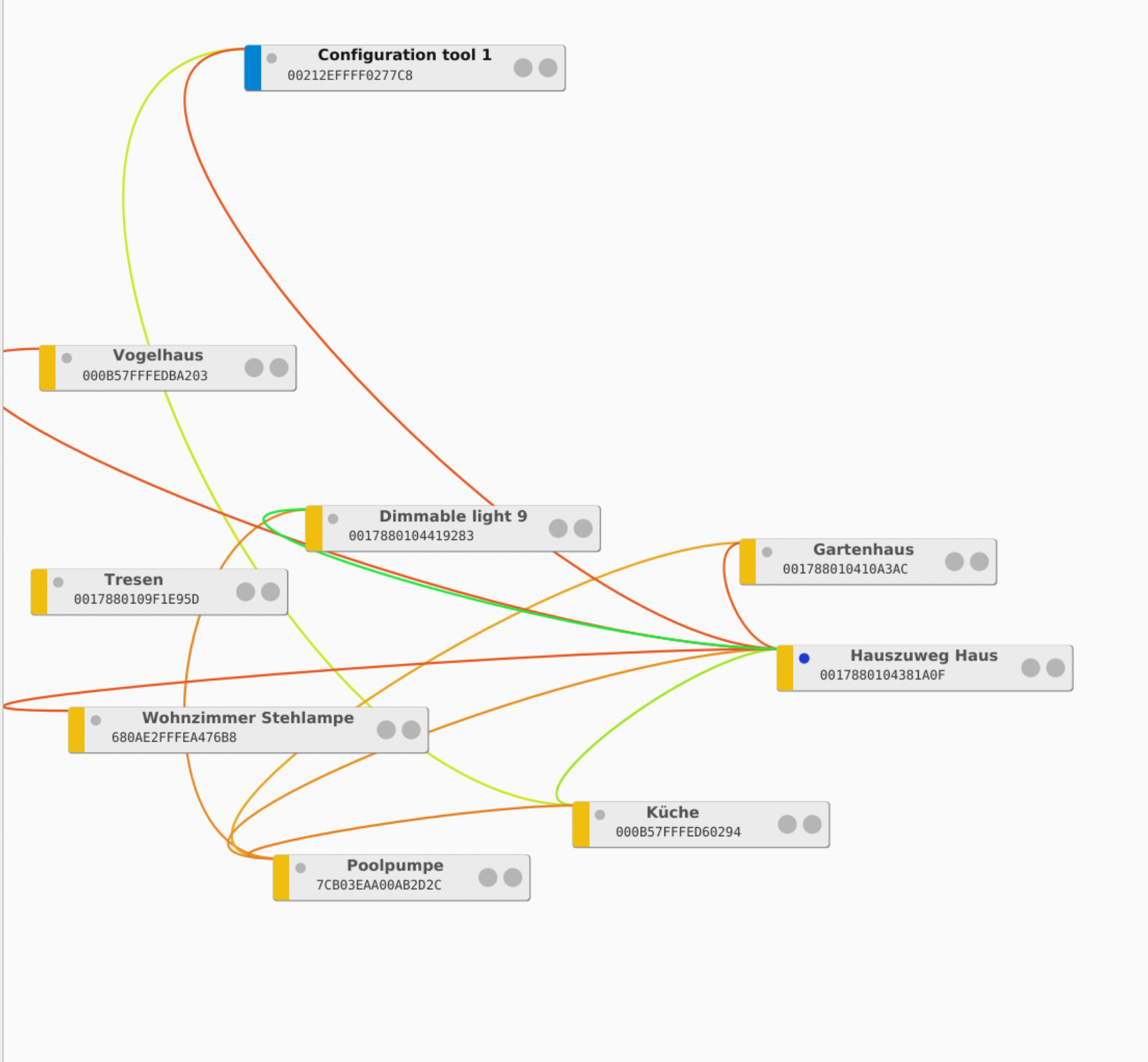

Now it’s getting even more strange. I restored the backup of yesterday morning and two other connections appear - but I can not control these two lights:
After a few minutes the connection to “Hauszuweg Haus” and “Küche” disappears again.
Just another few minutes later, lots of connections are there:

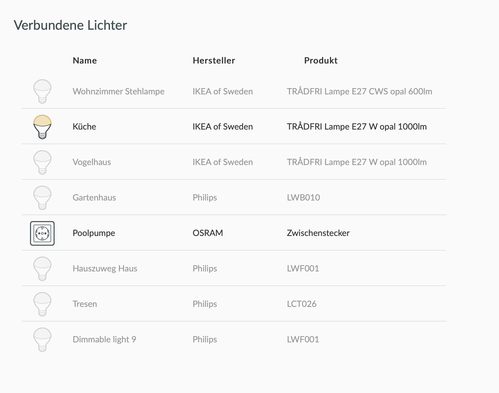

But the lights are not really reachable:
The Light “Küche” for example is not on…
