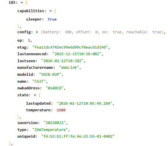

I always wondered why some of my SONOFF sensor report 2 decimal places, some others just one. Now I found out on Zigbee2MQTT it’s possible to set a temperature_precision SONOFF SNZB-02D control via MQTT | Zigbee2MQTT. But I cant find a cluster in deCONZ to set this. Is this just something that z2m does internally, is the cluster/attribute missing in deCONZ?

I have multiple SONOFF Sensors. Some Report
    "lastupdated": "2026-02-12T11:29:04.738",
    "temperature": 2031
and some
    "lastupdated": "2026-02-12T11:29:30.729",
    "temperature": 2010
(last decimal place is always 0).
