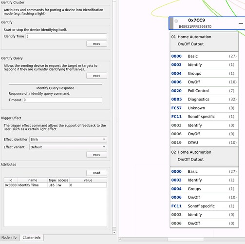

Sonoff MINI-ZB2GS-L
SONOFF MINI DUO-L 2-Gang Zigbee Smart Switch | MINI-ZB2GS-L
This DDF should cover the basic functions. Or better yet, make a device request here.
