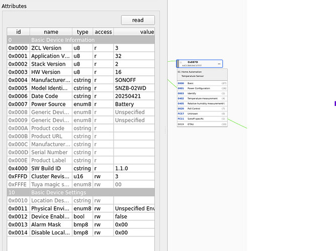

I recently got a new sensor that goes into the garage to measure temperature and humidity. This sensor shows up in deconz, but it does not in Phoscon. This leads to the sensor not being available in Home Assistant.

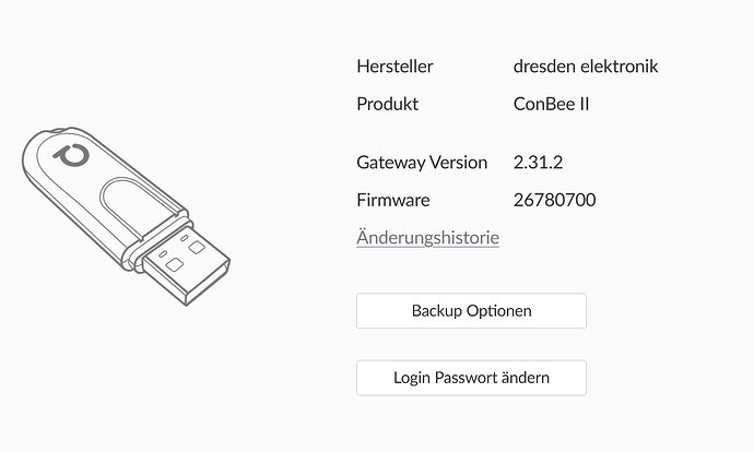

The device is only supported since version 2.32.0-beta, so either update your system or use this DDB. This can be uploaded directly to Phoscon; afterwards, remove the device and reconnect.
