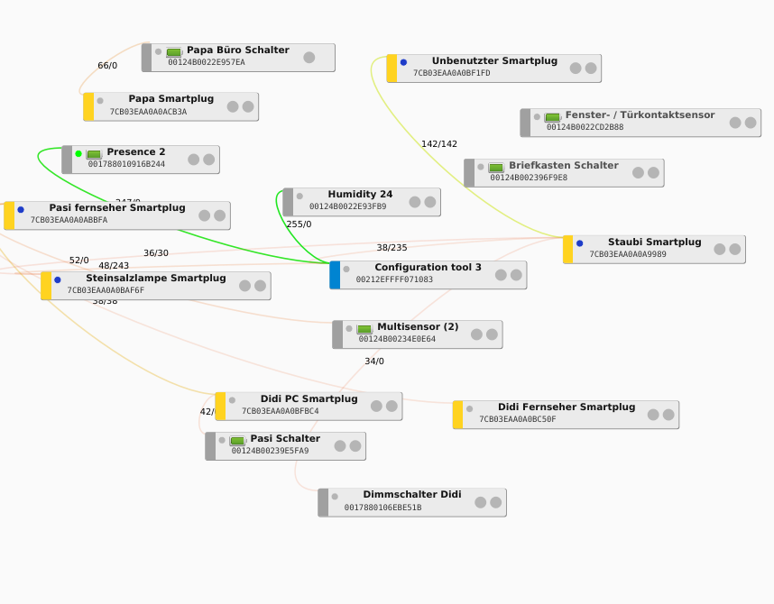

LQI values of most Routers are not up to par >
Indeed, it seems that the coordinator doesn’t have any strong connection to routers.
Do you have the ConBee connected via USB extension cable?
Yes, its connected with a 2 meters long extension cable and lies propped up nowhere near any other electronics.

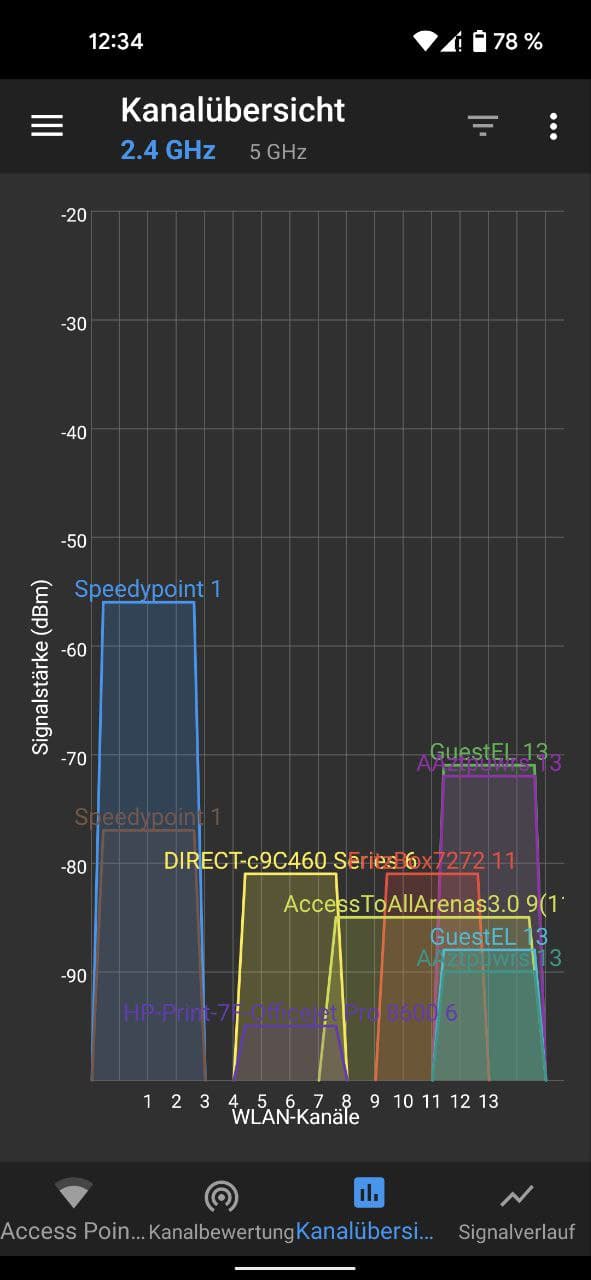

Ok that’s good. The next thing I’d check is that the Zigbee doesn’t have interference with other 2.4 GHz devices like WiFi and Bluetooth.

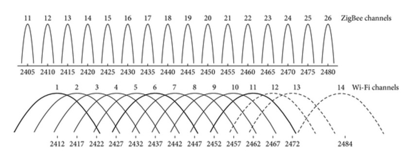

You can use a free WiFi scanner app on your phone, which shows networks nearby and which 2.4 GHz channels they occupy (note that Zigbee and WiFi channels are very different).
Usually Zigbee channels 11, 15, 20, 25 have the least interference.
Your Zigbee network is currently on channel 15, so it would be good to have WiFi channels 3–5 not too occupied.
Since the LQI values between your routers are so low, this can be either too long distance between them, or that they have a difficult time to reach each other. The distance between two routers, like lights and plugs, should only be 5–7 meters in clear line of sight to form a good connection.
I don’t think there is a much better channel around my house sadly. The things is, I have 3 sensor all not working, every one from sonoff. One of the sensors, Humidity 24, isn’t working either and it is right next to the conbee and has a perfect connection

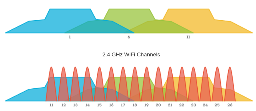

Hm hard to tell, channel 15 is already on the best place according to your WiFi screenshot it should be between WiFi channels 3–4. Here is a better channel diagram:

I don’t think so, at least from the network map the overall connections are pretty weak, from coordinator but also between routers. Therefore my guess that there is either something up in the air or the distance between routers is too large.
