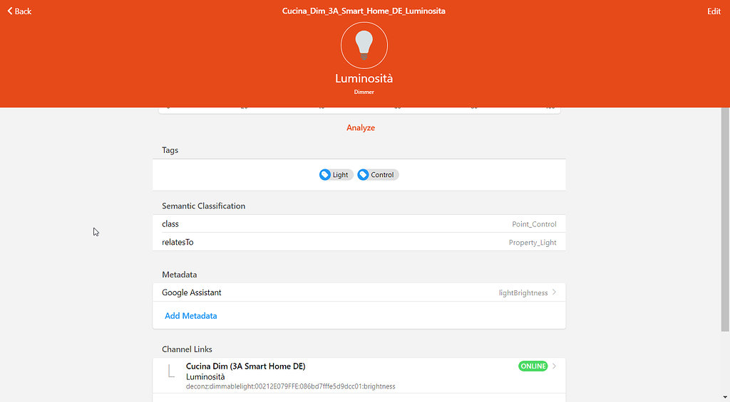

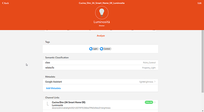

It was a bit of a struggle, but it works!
I have deCONZ in Docker.
I have openHAB in Docker.
I was able to integrate openHAB into deCONZ.
openHAB sees all my deCONZ devices. By linking openHAB to Google Home on my smartphone, I can control a smart plug with ‘ok google’ to turn it on/off.
openHAB can communicate with deCONZ and Google Home. I only use openHAB for that!
I used a Legrand Netatmo smart plug, and it works well. Discovering openHAB in Google Home is rather slow; you might think it’s not working because Home is stuck in a loop, but it does work!
I only use openHAB for “OK ​​Google” access; it doesn’t use any Docker resources.
I’m happy with the result. I’ll be able to do away with the Legrand Netatmo bridge by putting all the Legrand devices on deCONZ and keeping “OK Google.” No more proprietary bridges in my setup; everything is local with deCONZ. Only “OK Google” needs an internet connection. You need to create an openHAB account; it’s free.
