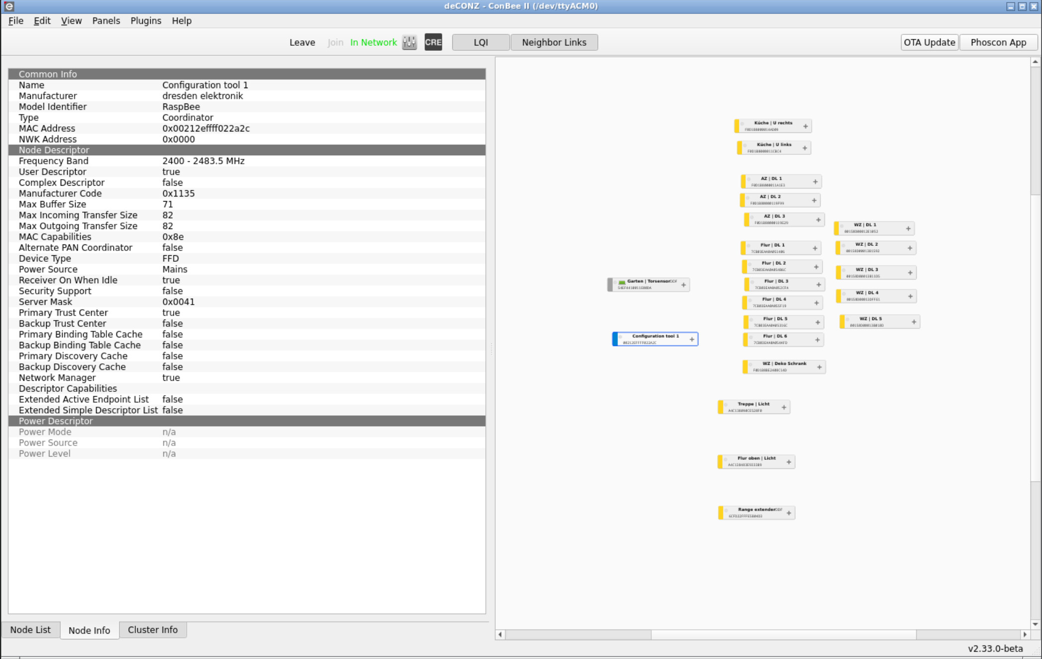

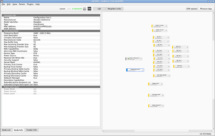

Did it. Because my conbee was bricked by firmwareupdate, I bought a ConBee II. After recovering the backup, all nodes back again. But they are not linked anymore. And they aren’t controlable. Is there any idea wat’s going wrong ? Why is the Model identifier still RaspBee ?
Hello, It’s almost impossible to break the conbee, you have tried all possible method from here ? Update deCONZ manually · dresden-elektronik/deconz-rest-plugin Wiki · GitHub
You have used the backup/restore feature from Phoscon ?
On Deconz, take a look on logs using Help/Debug view with flags “error” * 2 and “info” * 2.
