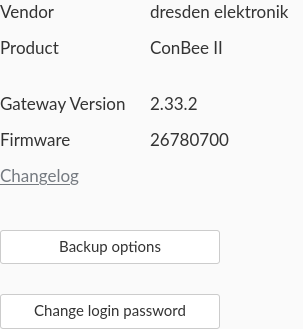

Now check if the ConbeeII stick is found by Deconz by going to Gateway in Deconz
There you should see something like this.
Now you can add devices.
