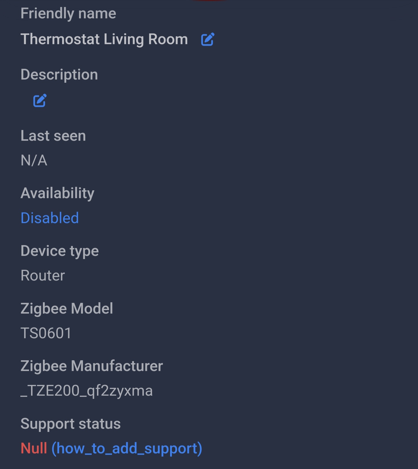

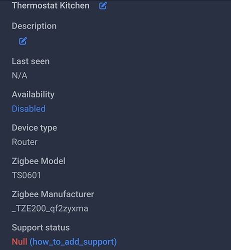

Hi, not sure this is the right thread but I’ll try my luck. I have a thermostat (_TZE200_qf2zyxma model TS0601). I have added it to zigbee2mqqt but it’s support status is null and the expose panel is empty, any idea what I should do?
Thank you in advance and sorry if this is the wrong place
I don’t found your device everywhere (on google). There is a typo or it’s a new device Request Device Support · dresden-elektronik/deconz-rest-plugin Wiki · GitHub
This is not a typo but it seems to a be a rather “unique” thermostat. It controls my infrared panel in my ceiling. I have contacted the company who provided and installed it but they don’t have a lot of info.
