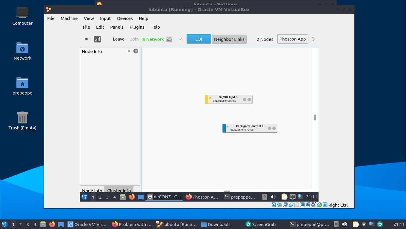

Here is a picture of the map before trying to include the sensor, with the coordinator and the router:
As you can see, it doesn’t show a link between the router and the coordinator (but, as said before, the router is reachable and I can turn it on/off)

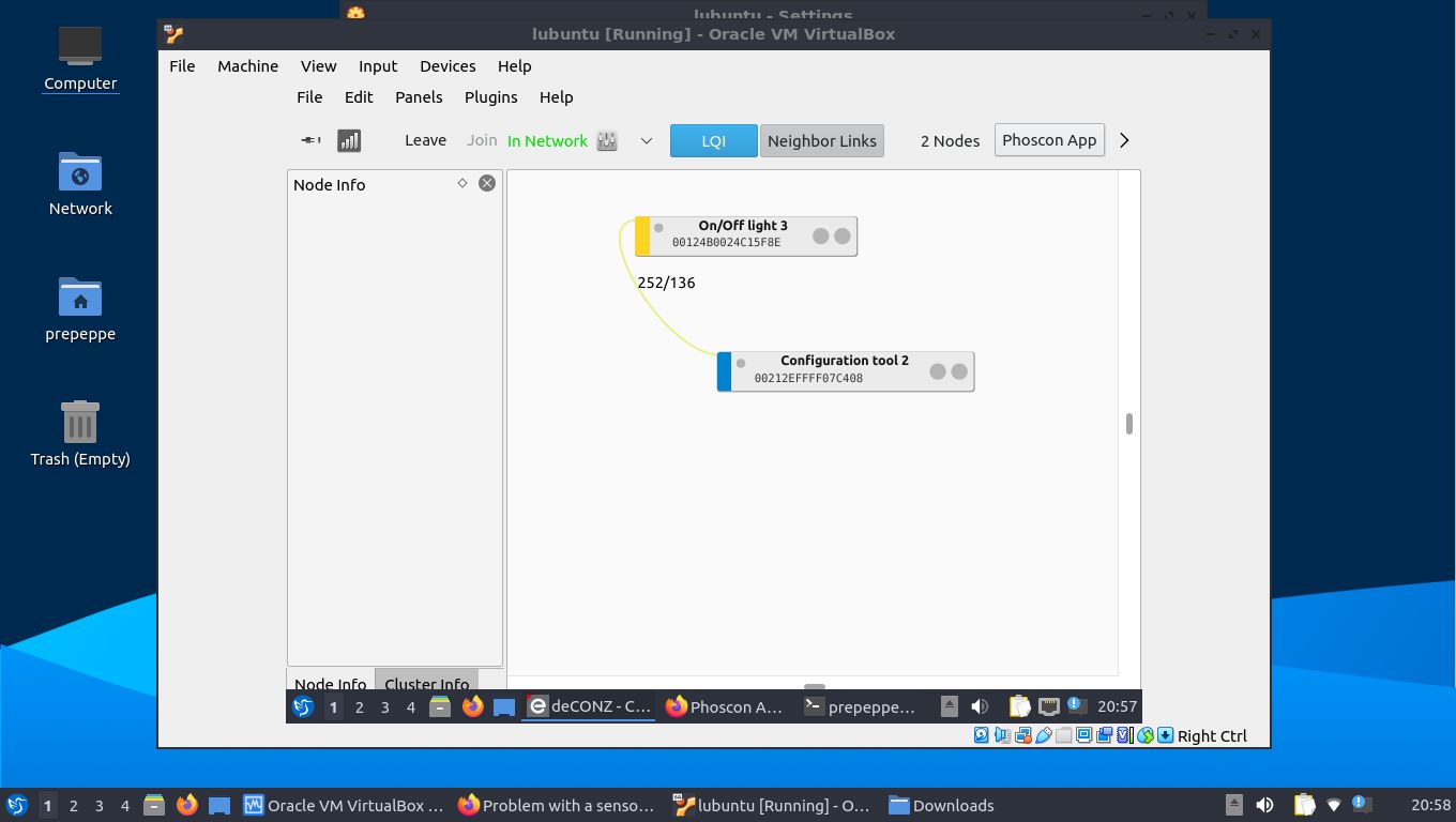

. If I move the router very close to the coordinator, I can see its link:
… but it is strangely weak, and not green.
Do you connect the ConBee with an USB extension cable (highly recommended)? The weak signal especially near the coordinator would indicate it might be caused by 2.4 GHz interference which can be mitigated with an USB cable.
I use an extension cable. In addition, I have chosen channel 25 as the zigbee channel (so, no interference with my wifi internet stuff). In addition, if I pair a door sensor near the coordinator as well, I can see strong signal (green). I also tried to pair another zbmini near the coordinator, and the signal is weak like the previous one…
I’m getting crazy with this!
