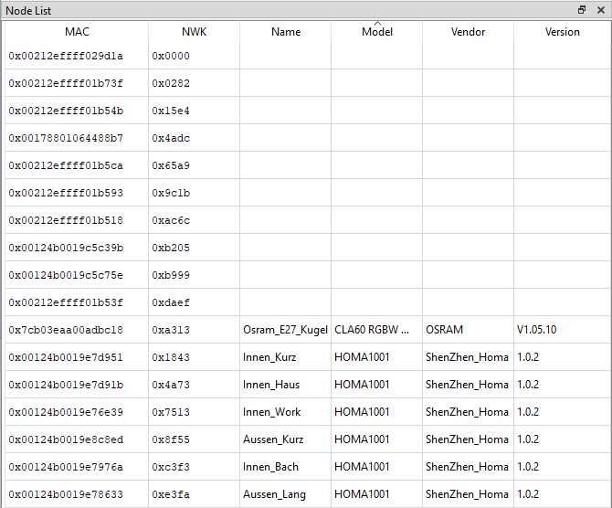

Yes, I tried:
I could see all lights in the node List but not one worked…
So I started new…
Now I have 4 of 6 lights + philips motion detector connected.
no switches.
backups do simply not work:
I tried to restore once more the backup from 2022 (last with working network) - no function
Then I tried to restore the backup from today - does not work anymore. :frowning:

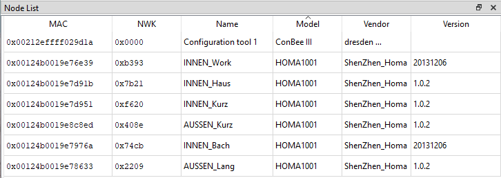

Attached the “imported” nodes - which did not work and the newly connected lights - which are missing today:
I already have tried the GitHub Network help (Disconnect - Save etc. Connect.
No Change…
Thanks!

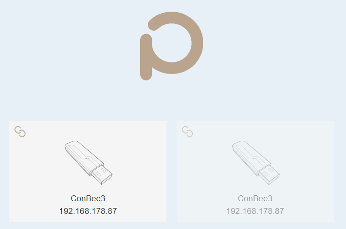

Do you know, why there are TWO Gateways listed on start of Phoscon APP (only one is active and can be chosen)? See attachment.

I think you have 2 deconz running. Deconz and deconz Gui.
You can check if you have 2 instances with
$ ps ax | grep deCONZ
or
$sudo systemctl status deconz
$sudo systemctl status deconz-gui
Only one of thoses last requests will give a positive result
