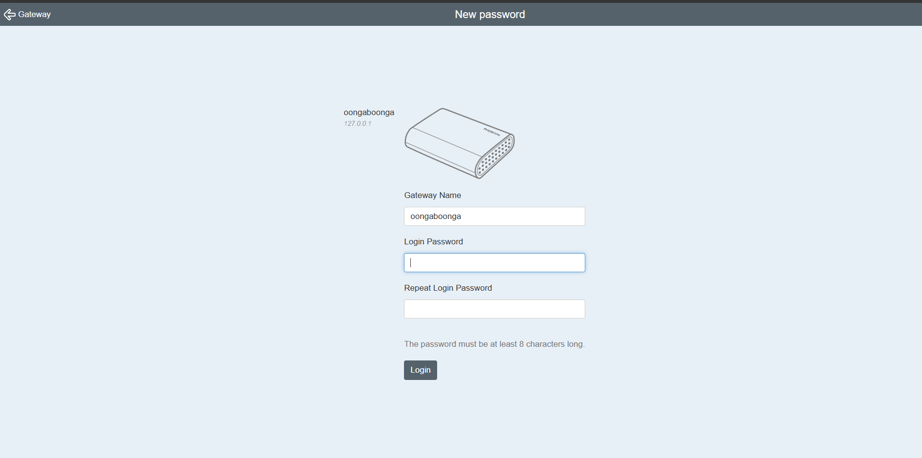

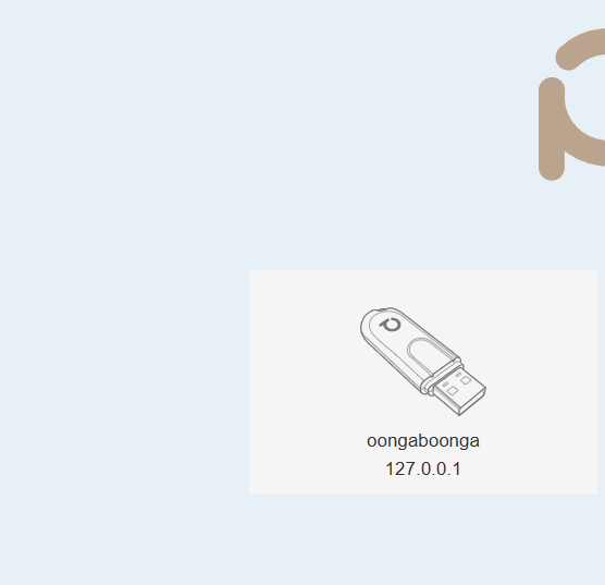

Using Conbee2 , only have a WINDOWS machine. Phoscon opens and shows my gateway, clicking on it takes me to “New Password” page, changing Gateway Name and Login password and clicking “Login” doesn’t do anything. Next time I open the phoscon app, the Gateway name is changed but I am stuck in the same loop again.
How do I access the webapp where i add lights and groups and control devices? I was only able to access it once at the beginning and have been stuck in this loop since.

Same problem here. Getting clueless …
Log says:
22:30:58:795 reuse recently created auth username: 4859044A51, devicetype: Phoscon#B759x632
22:30:58:795 apikey username: 4859044A51, devicetype: Phoscon#B759x632 already exists
22:30:58:806 API error 7, /config/password, invalid value, ZGVsaWdodDpkZWxpZ2h0 for parameter, oldhash
    if ((map["oldhash"].type() != QVariant::String) || oldhash.isEmpty())
        rsp.httpStatus = HttpStatusUnauthorized;
        rsp.list.append(errorToMap(ERR_INVALID_VALUE, "/config/password", QString("invalid value, %1 for parameter, oldhash").arg(oldhash)));
        return REQ_READY_SEND;
