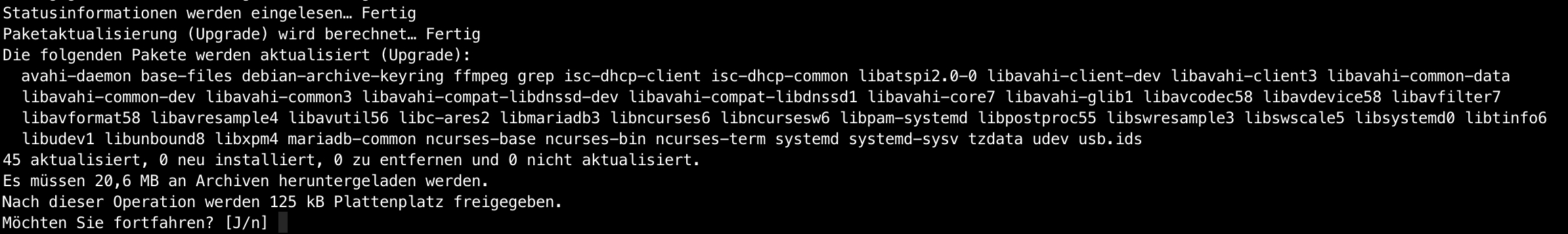

Seems there is a issue with some dependency in Bullseye:
opened 04:39AM - 01 May 23 UTC
Bug report
## Describe the bug
After a sudo apt update && sudo apt full-upgrade and a re… boot deconz no longer connects to the conbee 2.
The problem exists has occurred on three different Raspberry Pi with deconz.
The deconz window cannot be closed via the gui. There is a prompt to end the process. If this is confirmed with yes, the deconz window returns that the process is not responding. The window freezes.
Raspberry Pi 4 Model B Rev 1.1
Debian GNU/Linux 11 (bullseye)
Linux 6.1.21-v8+
deconz 2.21.02
ConBeeII_0x26780700.bin.GCF
The following packages were installed:
![IMG_4413](https://user-images.githubusercontent.com/27686185/235407451-055acfe2-1fc8-4181-8d1d-2e37c3312a72.jpeg)
![IMG_4415](https://user-images.githubusercontent.com/27686185/235407613-b83e893b-d99e-4f81-b7de-0993a5426050.jpeg)
![IMG_4414](https://user-images.githubusercontent.com/27686185/235407616-9009bd13-8b8c-4281-9b42-9ac2c81d5458.jpeg)
