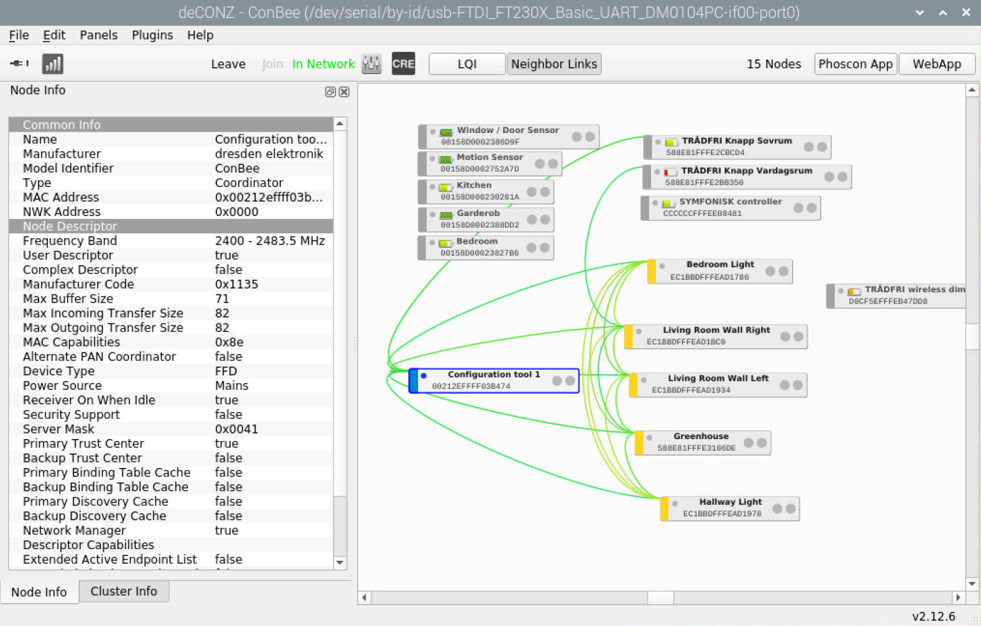

Setting everything up and just replacing the zll.db file seems to have every device show up in the deCONZ GUI and connections light up for all expected devices. Switches are also able to control the lights which were configured before the SD-card crash.
Now, all of the Zigbee dimmers (Philips | ZG9101SAC-HP), appears as disconnected (not reachable?) in the Phoscon App and cannot be controlled from the Phoscon App, except pressing ‘All off’ which actually turns everything off. I have a TRÅDFRI switch which works properly and can be controlled without issues.
I tried integrating with a Home Assistant installation (from another machine) and this still shows the issue with the light reporting as off/disconnected. However from the Home assistant installation I am able to turn the lights on, but the status is reported as off a few moments later. I’m also able to control the dimmer level without issue from within HA but the light is still reported as off. The TRÅDFRI switch is reporting it’s status and works as expected in HA.
