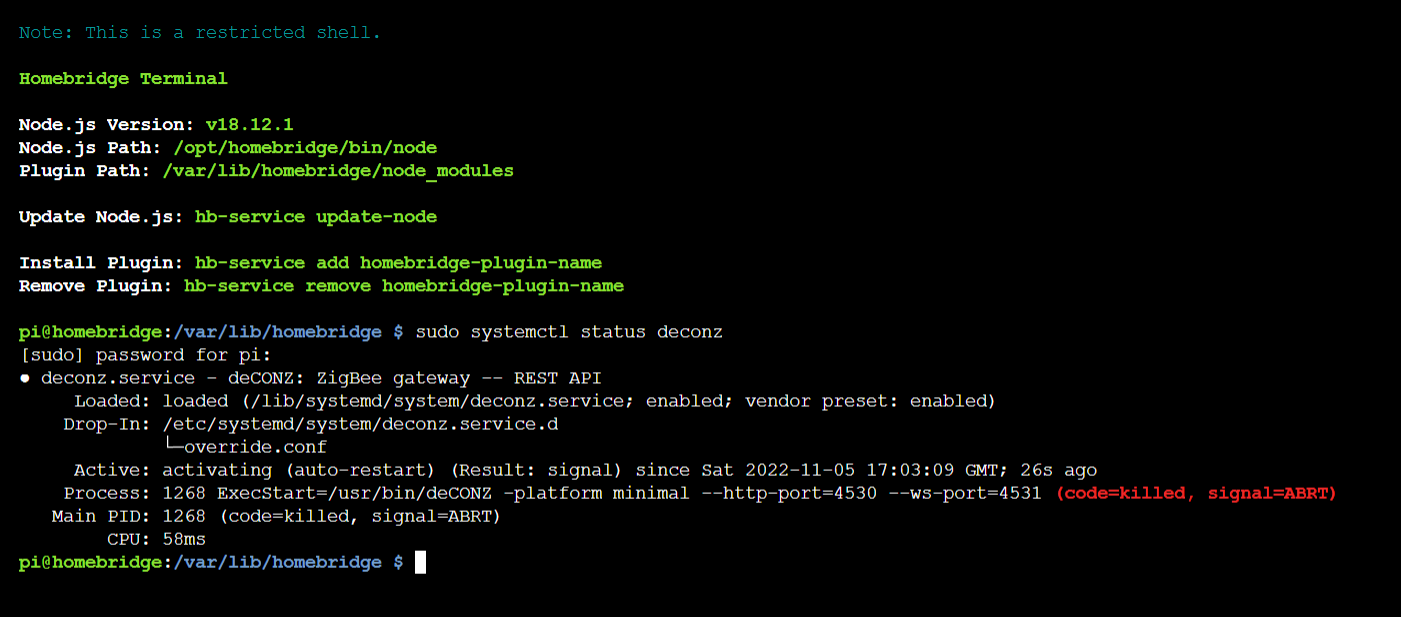

But now my homebridge can’t connect to/find the conbee. Since I am a total noob I’m not sure why. I have not changed a thing on the setup. I Googled some stuff, tried some stuff… but I can’t seem to find the problem.
try running with command line and logs /usr/bin/deCONZ -platforminimal .......
You just need to make a copy/paste from the previous command, you have the complete command on your capture, can add --dbg-info=2 --dbg-error=2 to have some logs, but can be tto talkative for sd card, so if you haven’t error message, stop with Ctrl+C
