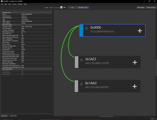

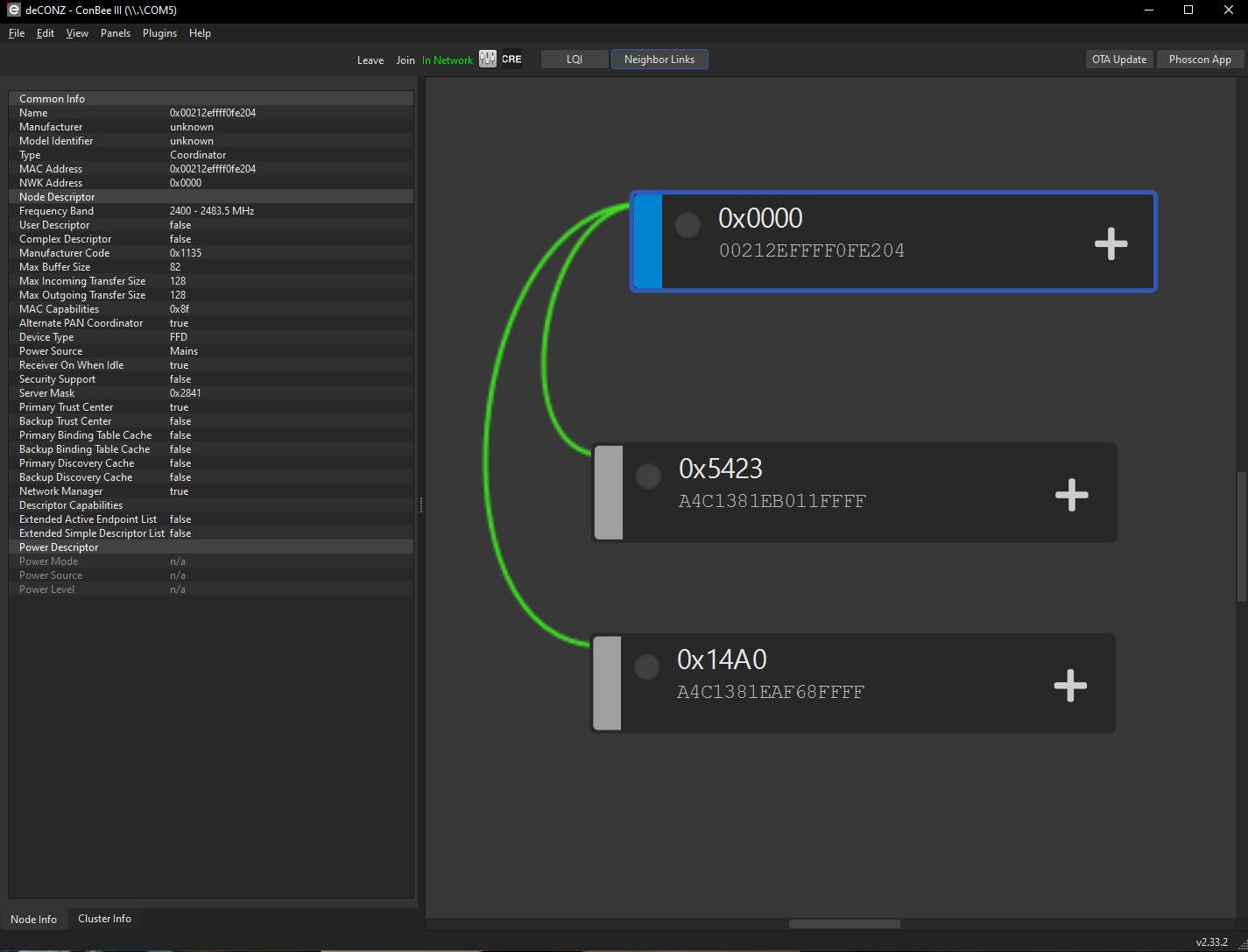

I managed to get the Conbee set up, flashed the latest firmware on it and have the deCONZ software running. I unwrapped two of the sensors, put in batteries and got them to be connected:

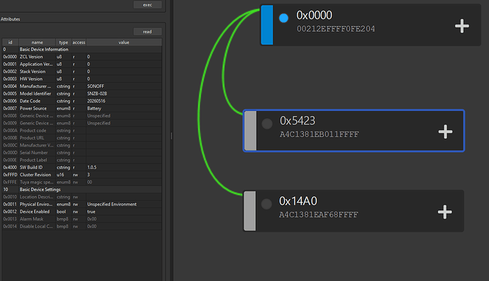

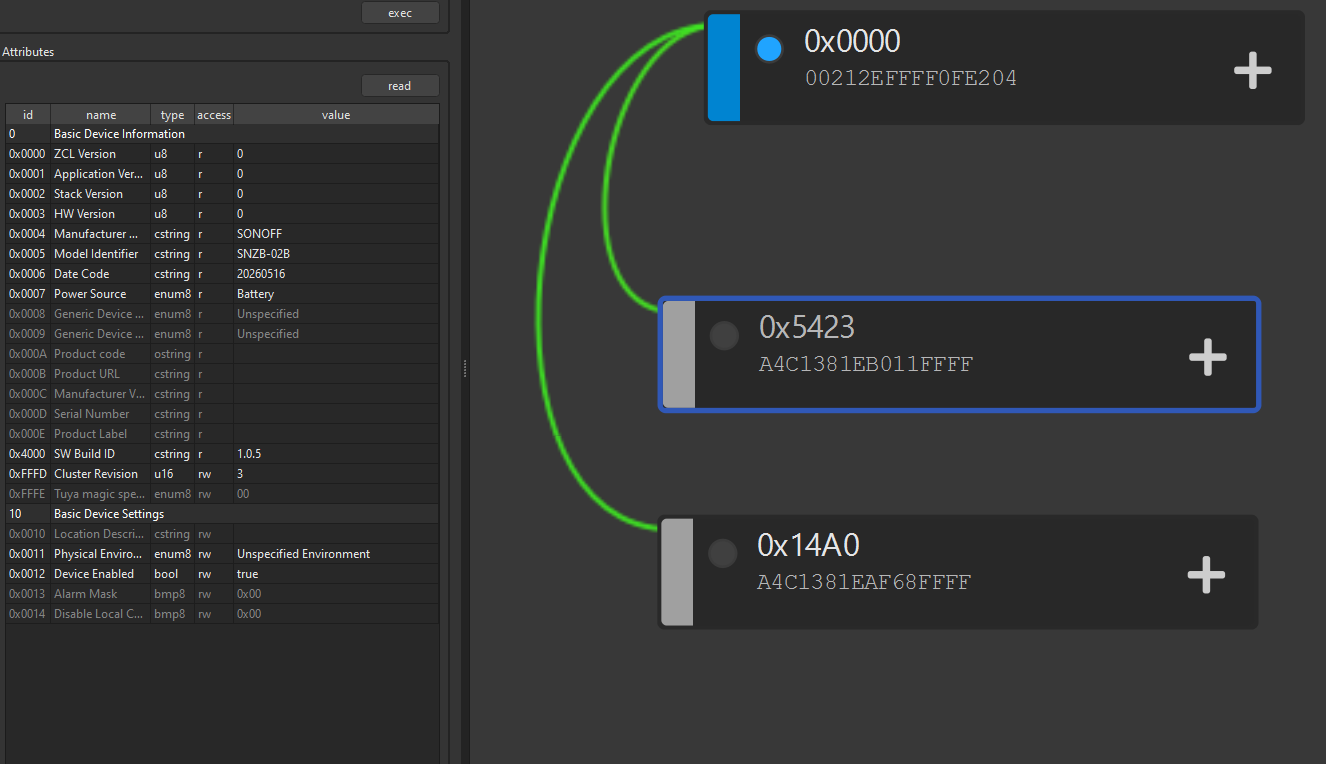

I’ve seen other screenshots of this software where the devices had human-readable names instead of hex addresses. AI suggested to me that this is because my sensors are not “fully connected yet”. To remedy this, I restarted the software a couple of times, manually read the Basic Cluster and also unplugged and replugged the dongle itself. All to no avail. When I read the basic cluster, I do see manufacturer information:
