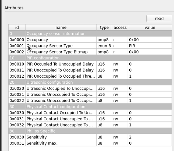

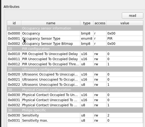

Hi, I’m having the same issue with an Outdoor Motion Sensor. Light and temperature are working ok, but it’s not detecting motion. I also noticed in the GUI that this sensor as the ID 0x0030 as 0 (and I can’t change it), while a working sensor as 2.

the value 0x00 does not switch to 0x01 like all other sensors. Any idea what could be the reason?

Setting the sensitvity to at least 2 (max is 4) the motion detection works fine, I am very confused why this is necessary with Conbee 2 and deConz, with the HUE bridge the sensitivity to 0 also enable motion. All other sensor also set to 0 and they are working well.

I ran into the same problem with a SML004 / 2.53.6 motion sensor.
The device stoped sending motion events while an older SML002 / 6.1.0.25261 motion sensor kept sending evnts.
Comparing the configurations in the Deconz UI showed that the sensivtivity of the SML002 was set to 2 while the sensitivity of the SML004 was set to 0. Changing the setting of the SML004 to 2 solved same problem. The sensor is now reporting motion events again.
