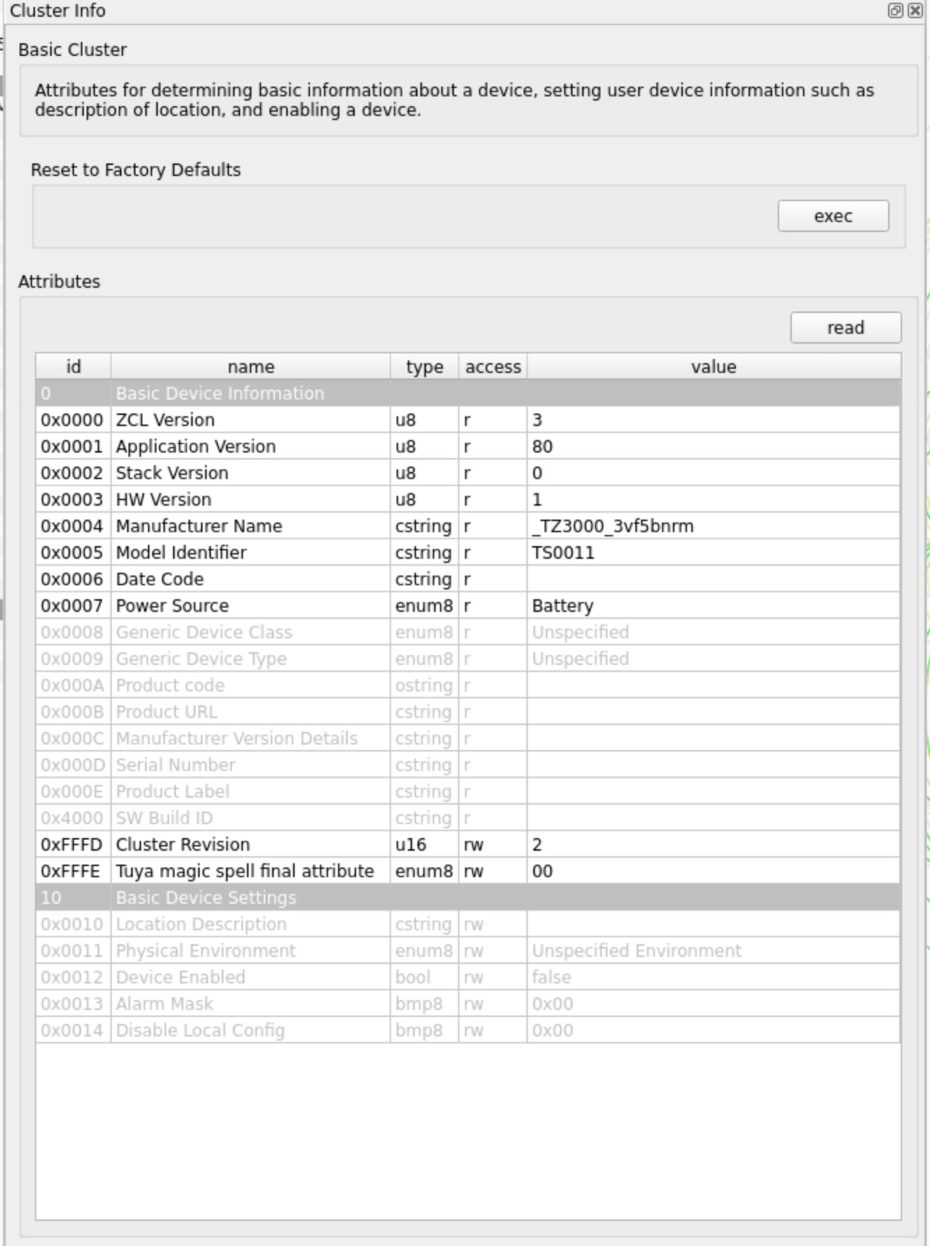

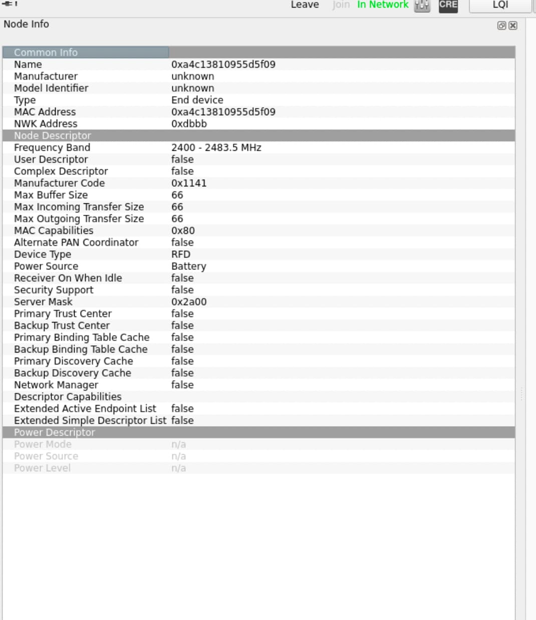

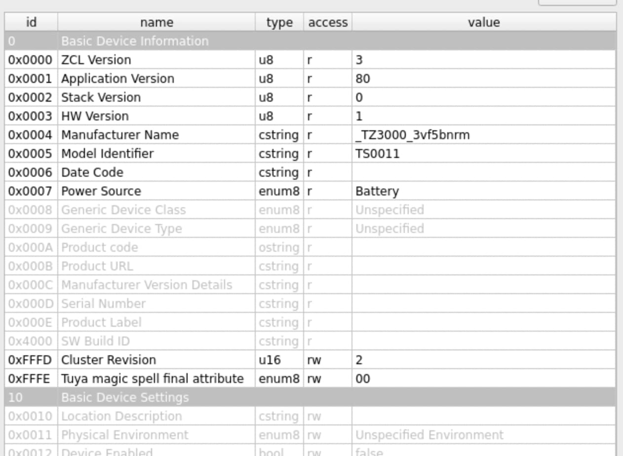

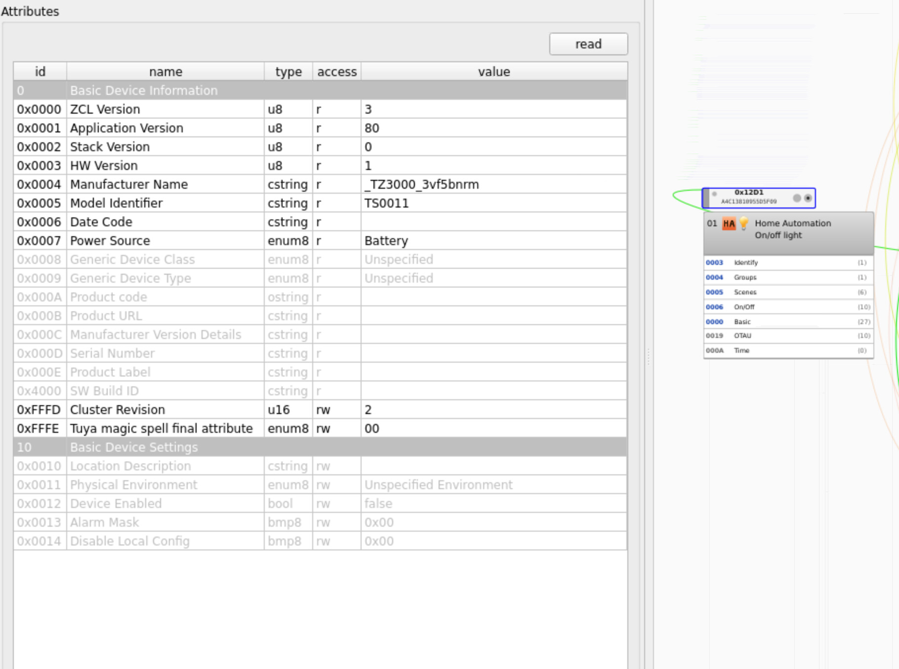

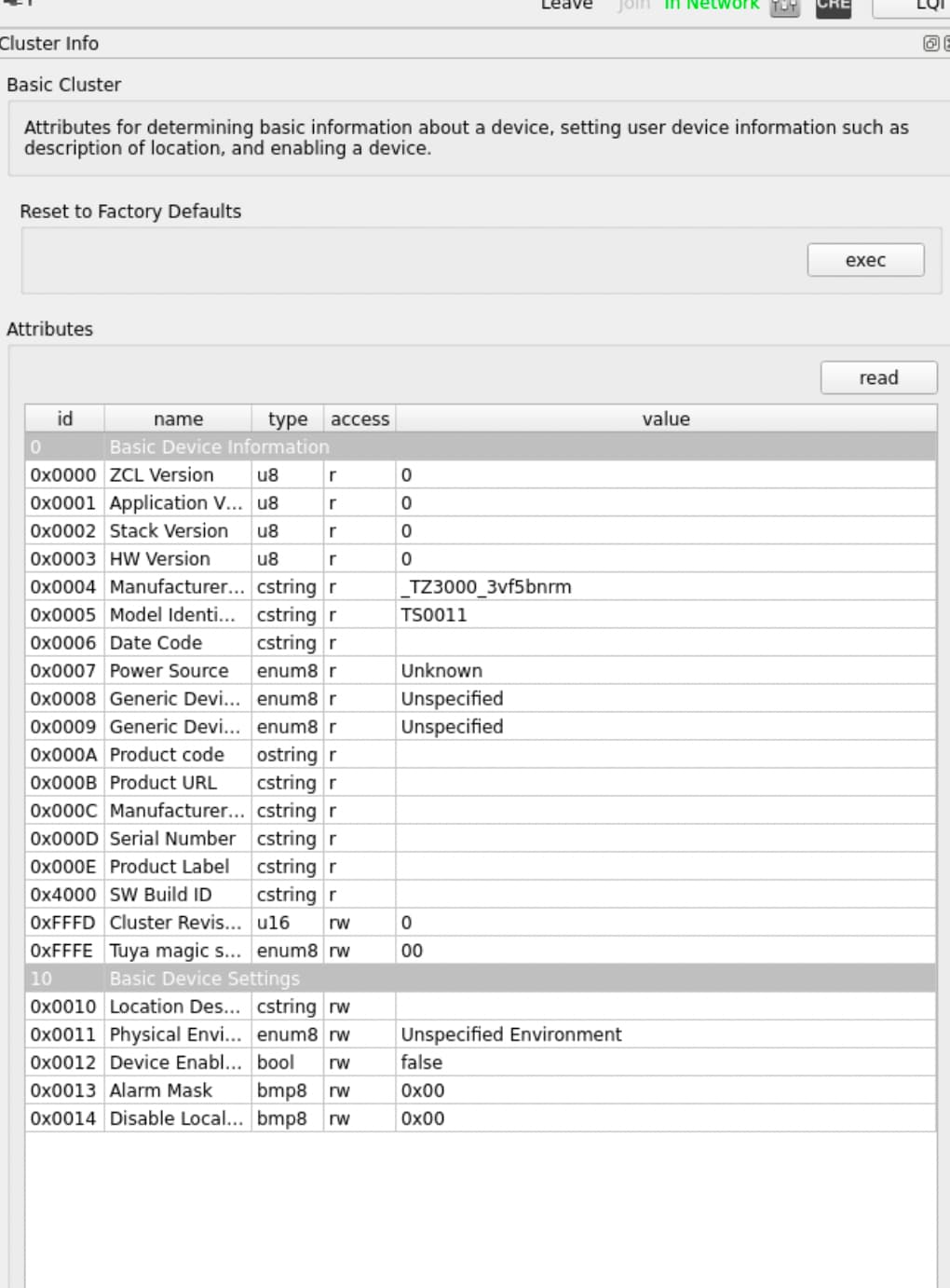

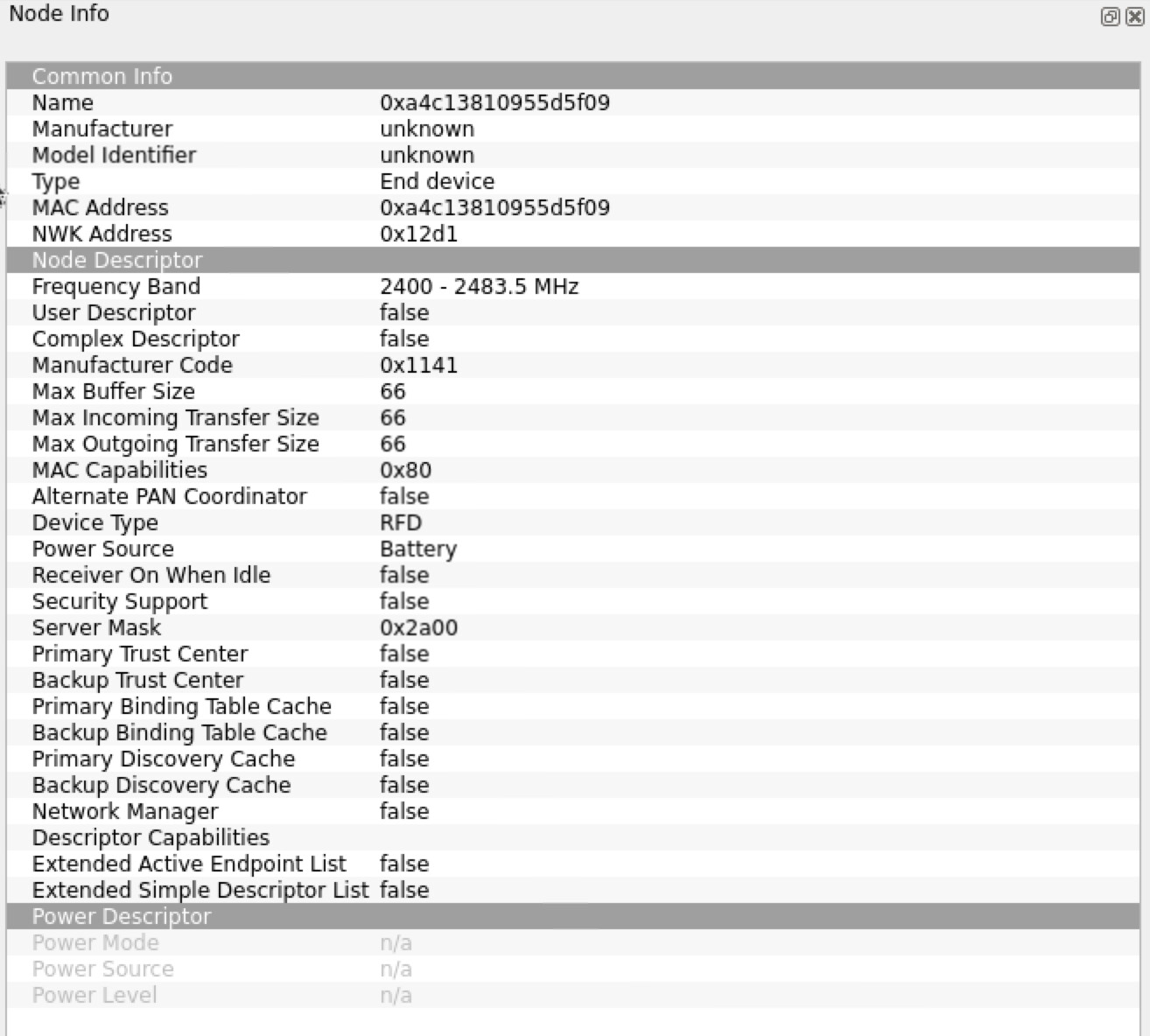

Can you provide a screenshot of the basic cluster in deconz?

Hello!
Unfortunately I don’t know what exactly you mean?
Check the GitHub, there’s a wiki page.
Other than that check the deconz manual.
What do you have to change to get it displayed?
Hello, it’s a new device, you can make a complete device request Request Device Support · dresden-elektronik/deconz-rest-plugin Wiki · GitHub

Hello!
Many thanks for your response.
Unfortunately, I can’t figure it out. The device has a manufacturer and also a model identifier.
I don’t know what I’m doing wrong.
As a test, we tried it with a Phillips Hue bridge and we recognized the device and it worked perfectly.
I hope you can help me with this.
Please create a request as mentioned Request Device Support · dresden-elektronik/deconz-rest-plugin Wiki · GitHub
After that, we work on integrating.
In a new GitHub issue. Together with all other screenshots requested
