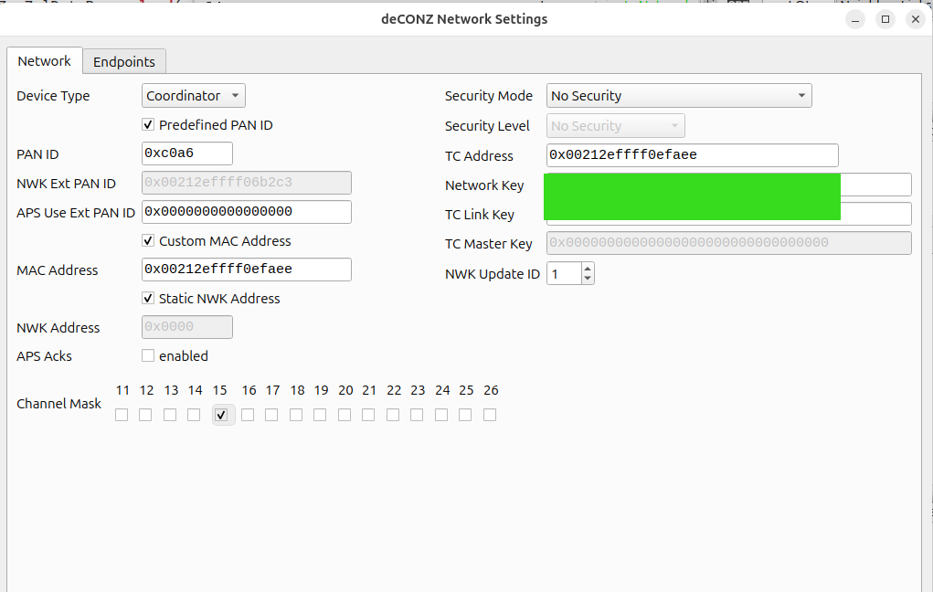

I had to re-setup my Phoscon Gateway (RPi migration 32bit to 64bit). After installation and configuration I fail to onboard Zigbee devices from previously (working) setup.
Steps conducted:
  • fresh installation deconz installation (Rpi 64-bit based Ubuntu, Gateway version: 2.28.1, Conbee 3 FW: 26530900) based on ConBee III Installation
  • starting deconz with fresh configuration
    ==> no device found
  • flashing Conbee device (tried older and latest firmware version) - GCFFlash shows the Conbee device with its serial properly
    ==> no device found
  • implemented configuration backup from old installation
    ==> devices are shown in Phoscon/DeCONZ-GUI but no connection being established
All devices are in a receiving state, Paulmann Amaris Zigbee Paneel in pairing state.
What am I missing to this being reestablished? Thanks for help!

Thanks for quick reply! No major discrepancy that I can see from log. I might see that there has been some attribute changes to the DB structure, seeing line 456ff. Though, no indication that this would hinder connection to the devices.
I’m attaching the log for reference.
Thanks for help!
Attaching relevant section of the log, couldn’t upload full log here. Let me know what is the best way to share with you the full log.

@Smanar I got my old stick and followed the steps but connection to ZigBee devices still fails. Need your advise how to continue - currently feeling a bit lost.
What I did:
  • used the previous ConBee II stick ==> deconz GUI still showing supposingly wrong …B2C3 address (I understand address comes from backup config as you pointed to config file in backup rar, though this was still the purged installation)
  • installed the available backup
  • followed the instructions here Network lost and configuration restore does not help · dresden-elektronik/deconz-rest-plugin Wiki · GitHub
  • forced tampering of MAC address via config in deconz GUI, see screenshot below
  • changed to “No Security” mode as I understand client certificate might be a problem
    ==> still no change, I’m not able to establish a connection with any of the devices
Thanks for help!
For the “TC key” , you need to have the same one than on the Capture (it’s always the same)
You can use the same Security stuff (so the “hight”)
Your device reconize the coordinator with the MAC adress, so you need to have the same one, (the backup store and restore it too)
And use the Network key to crypt data, so you need to have same too.
NWK update id is the number of time you have updated your zigbee setting, so 1 mean never.
On the first capture this value was 7, and you had different PANID, and a different channel.
You can compare the “deconz Network setting” panel with your both conbee, you need to have the same thing, else it mean there is a problem, when your restore your backup.
