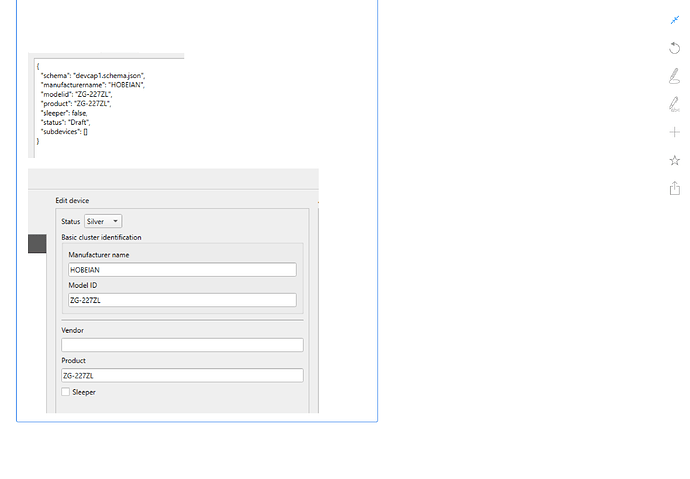

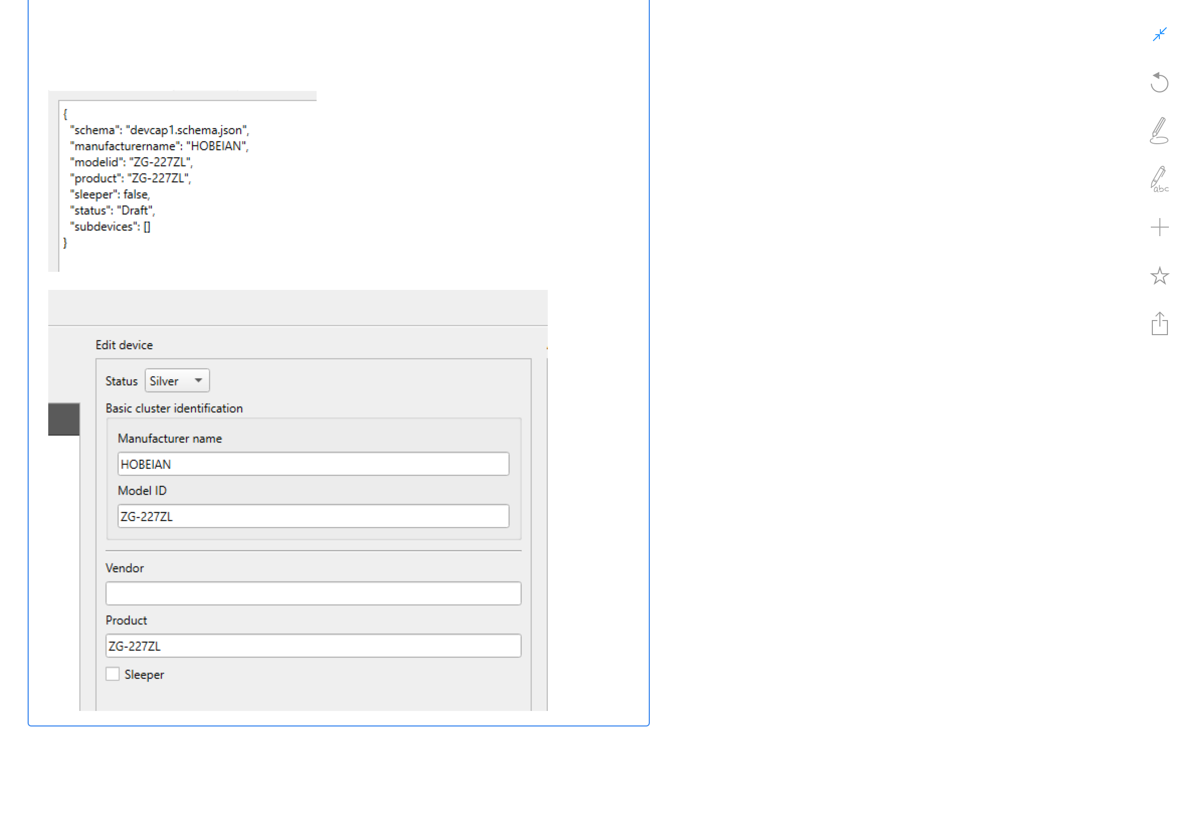

Cluster 0x0000, you can see them on the attribute table.
Unfortunately I donā€˜t see it because I donā€˜t use the GUI (due to performance reason). Is there another way to see it, maybe in a file or directory or database on the Raspberry?
The easier way is making try on a machine with a complete OS just time to have information.

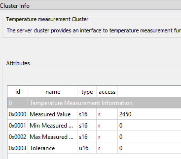

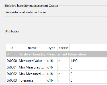

Thx for your advise. I installed deCONZ on my laptop.
I got the following info. I hope that helps
Your device is not yet supported. Please open a device request here.
